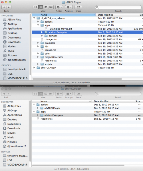

1. XCODE Downloaded and installe (latest version)
2. of_v0.7.4_osx_release, and ofxFFGLPlugin downloaded
3. Copy the /addons/ofxFFGLPlugin directory to the /addons directory of openFrameworks.
DONE (PIC 1)
4. Copy the /apps/addonsExamples to the /apps/addonsExamples of openFrameworks.
DONE (PIC 2)
5. Open the project file for one of the examples.
DONE (PIC 3)
