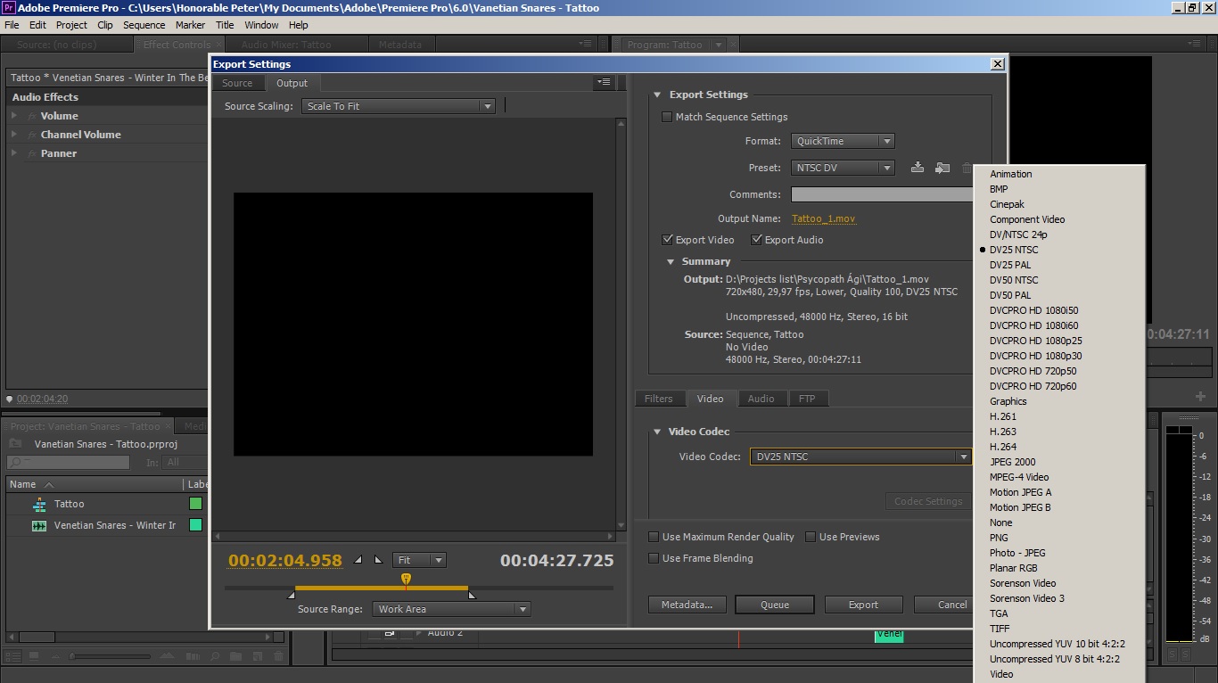

HI everyone, i'm in desperate need of your help.
I want to export useing dxv, with premierpro cs6, and despite quictime 7pro installed, it is not listed. I know its a .mov codec, i searched and found another user asking for asistance with the same problem, but the topic was closed without helpful conclusion.
Tried exporting with MPEG stream, Encoder even Quictime PRo, nowhere is it listed.

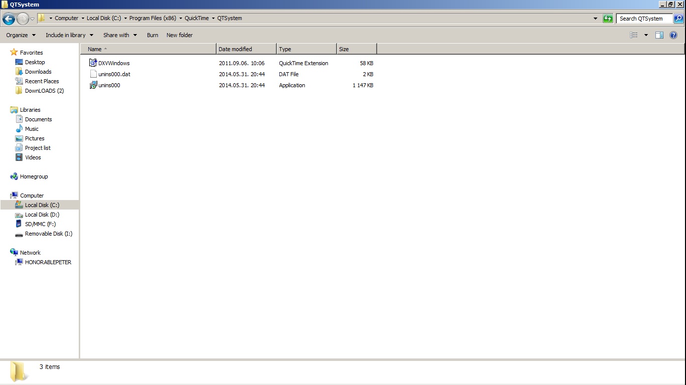

Do you have Quicktime installed in the default location?
Could you send us a screenshot of your QT codec directory?
C:\Program Files\QuickTime\QTSystem

Your QTSystem Folder is way to empty there sould be much more QT related stuff in it.... I also had some trouble installing QT-Alt. and QT at the same time...
first, give it a try:
- De-install Quicktime Alternative
- Install Quicktime to the offered default path
- Install the DXV Codec manually DXV 2_2 for Windows
Now the DXV Compressor should shown up in AFX and Premier Pro...right?

This did the trick! Reinstalled QT, Resolume and the codec, but its finaly listed at Premier Pro export settings. Thanks forum!
