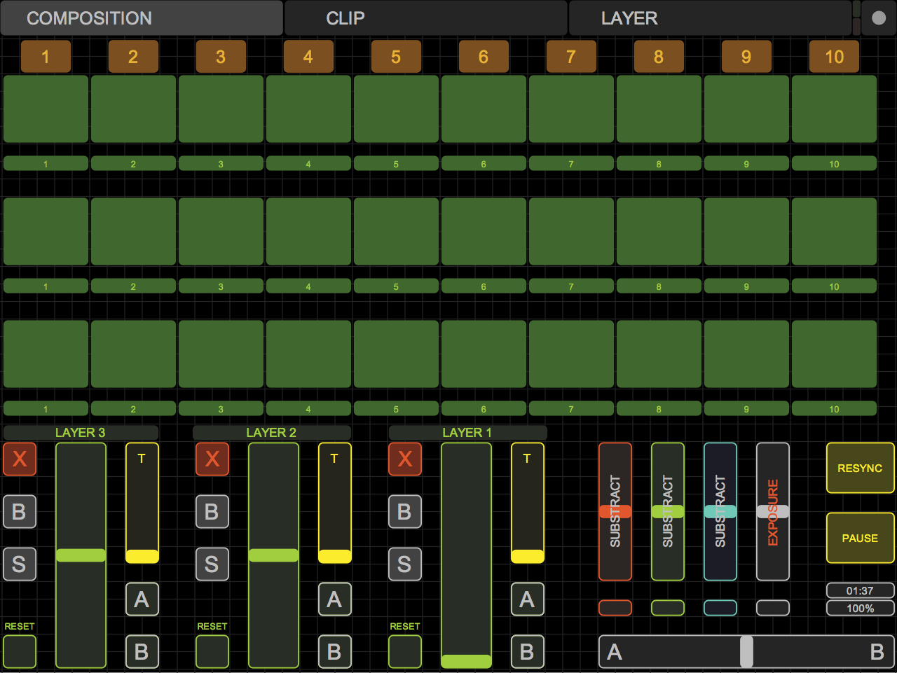

-10 buttons for COLUMNS
-3 layers with 10 clips
---small buttons with numbers are "preview clip" and shows the name of the clips loaded
-LAYERS
---X clears clips from layer
---B bypass
---S solo
---RESET for layers 2 and 3 moves fader to 50%
---OPACITY FADER
---RESET for layer 1 moves fader to 100%
---T FADER
------Transition time
---A & B assign layers for crossfader
-DASHBOARD
---ADD SUBSTRACT RGB & EXPOSURE (you have to add this FXs to Composition and link them)
---SMALL BUTTONS reset values to 50%
-RESYNC
-PAUSE
-CROSSFADER

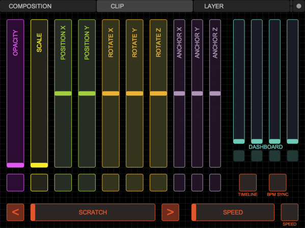

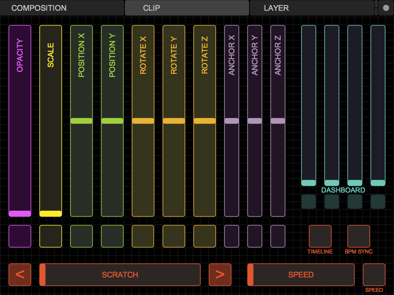

-FADERS
---OPACITY
------Button moves fader to 100%
---SCALE
---POSITION
------Button moves fader to 0
---ROTATION
---ANCHOR POINTS
-DASHBOARD LINKS 1 to 4
----Buttons moves faders to center
-TIMELINE
-BPM SYNC
-SCRATCH
---Buttons on each side plays backward and forward
-SPEED
---Button moves fader to 1.00

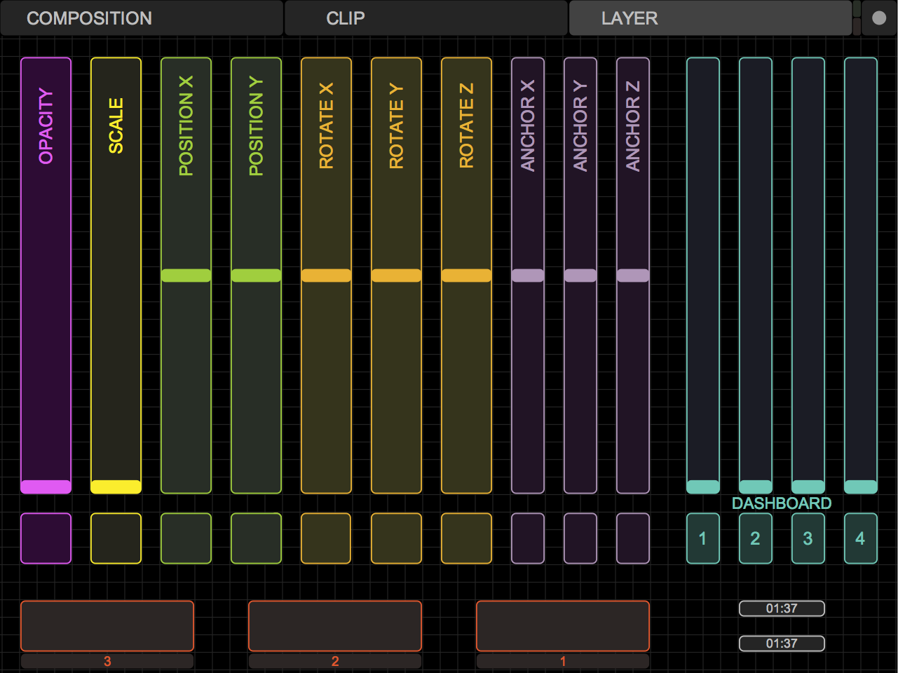

-FADERS
---OPACITY
---SCALE
---POSITION
---ROTATION
---ANCHOR POINTS
-3 BUTTONS FOR LAYERS
---Labels at the bottom gets the name of each layer
