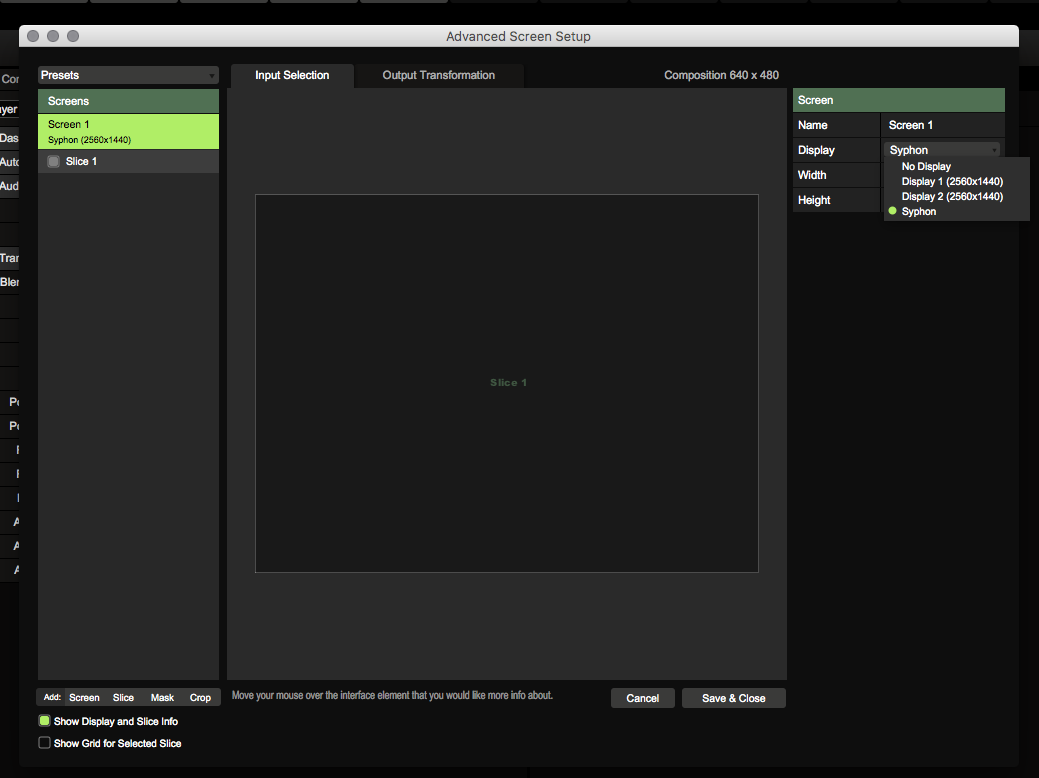

When output of arena 4 is passed through SYPHON
Advance screen setting is not reflected. Is there a solution to this phenomenon?
Re: The advanced screen setting is not reflected when going through the syphon
In Arena 4, after you enable Syphon via the Preferences, the main Syphin output will always be the composition output.
If you want to send out the Advanced Output as well, you can select Syphon as a destination for the screen you want to send out. Then this will show up as Syphon Server with the name you have given the screen in the Advanced Output.
