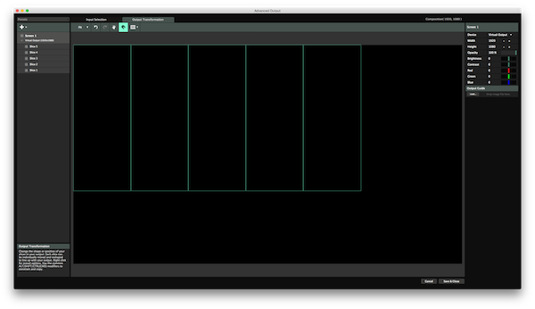

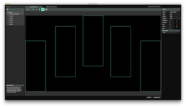

Okay, let's walk through a basic example. Let's assume we have a stage consisting of 5 LED pillars. In the processor they are positioned like this:
On the stage, they look like this:
Nothing spectacular. right?

What your first move will be, is to take these slices as they are, duplicate them and re-arrange them so they take the center of the comp as input. Then let's say we make it possible to assign midi shortcuts to slices. So you'll assign a midi shortcuts for these 5 new slices, as well for the five original ones. Great, you can fade two looks in and out.

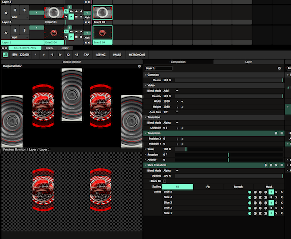

What we suggest is the following: set up your Advanced Output once. One slice for each screen. Close it and leave it alone.

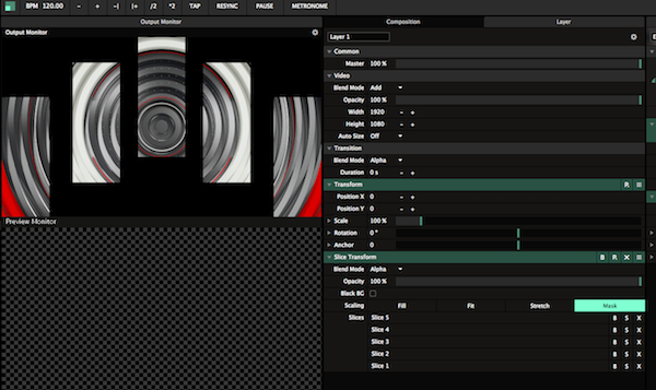

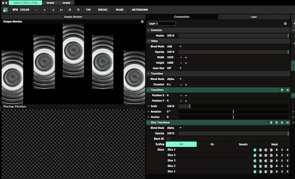

In the composition, apply a Slice Transform effect on each layer, using the five slices from your AO setup. If you want to have the layer fill the stage, put it on Mask. If you want to duplicate the content, put it on Fill.
There, you're done. It doesn't get any quicker than this.
All of these are midi assignable. If you want to show content only in a single slice, bypass or delete the others. You can even make presets for these looks, and copy them to other layers to mix and match. Do you want a single clip to use a different look? Apply the Slice Transform on the clip.
Bonus advantage, your preview monitor looks like your stage. Do you want to mirror the look? Instead of creating yet another 40 slices with 40 shortcuts, just use a mirror effect.
