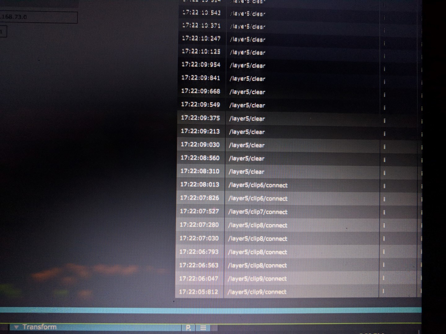

I found that with everything set with the right ip and ports etc, and also using OSC monitor, messages were being transmitted to the resolume PC but nothing was happening in the software itself.
I noticed the little triangle on the OSC settings page and saw this:
Please forgive the photo and not an actual screenshot. So OSC messages are getting into resolume 6 but not causing clips to fire.

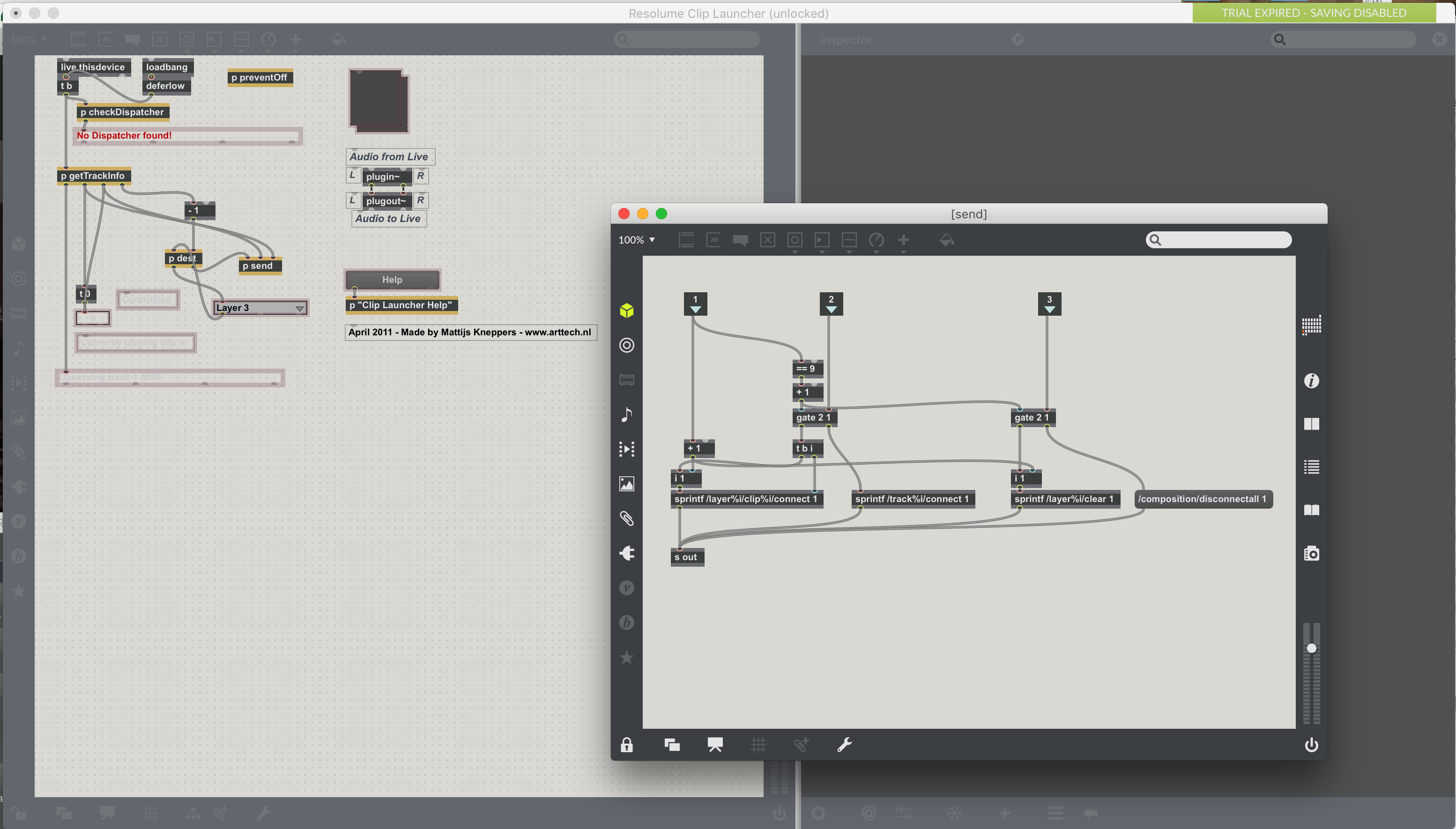

The addresses are in the "p send" object in the Resolume clip launcher patch.

Zoltán wrote:
Typhoon wrote: Ok. So it seems this plug ins are out of date. For someone with no max4live experience how difficult would it be for me to fix this problem, or do you or anyone else have an easier/better solution to get ableton and resolume to work together?
The plugins also work with Resolume 5 with their current addresses.
The OSC addresses in the patch can be rewritten quite easily with MAX, unfortunately my MAX trial has expired.

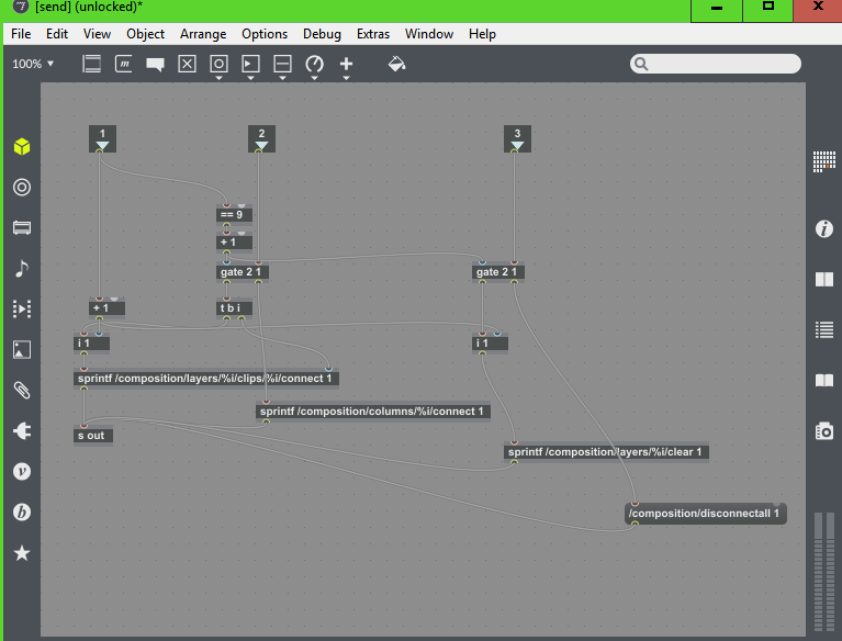

It should be the sprintf line
replacing "/layer" with "/composition/layers/"
and replacing "/clip" with "/clips/"
and also "/track" with "/composition/columns/".

Post by Typhoon »
I think that has done it!
I edited the patch as you said and it seems to be working!
My edits are as above.
I have included the patch here:
