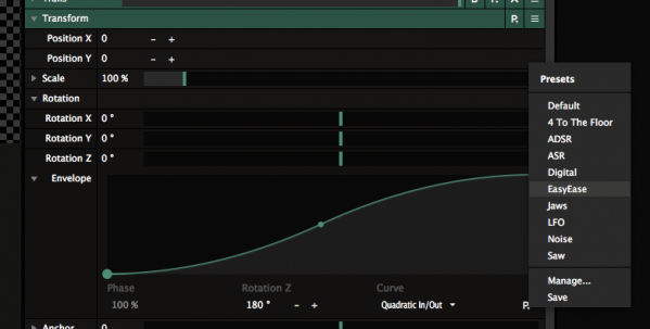

We've only heard about Compton in rap songs but like Eazy-E, we did get the 8 ball rolling. Here is Resolume Avenue & Arena 6.0.8. This version has more than 40 ounces of bug fixes and is packing some nice additions to the Parameter Envelopes. You can now create envelope presets. Edit the parameters of an envelope keyframe and when you're done fold it to make it smaller.

Nice one thanks. Are there meant to be any bundled Envelope presets as I don't see any at the moment.
Cheers
Richard

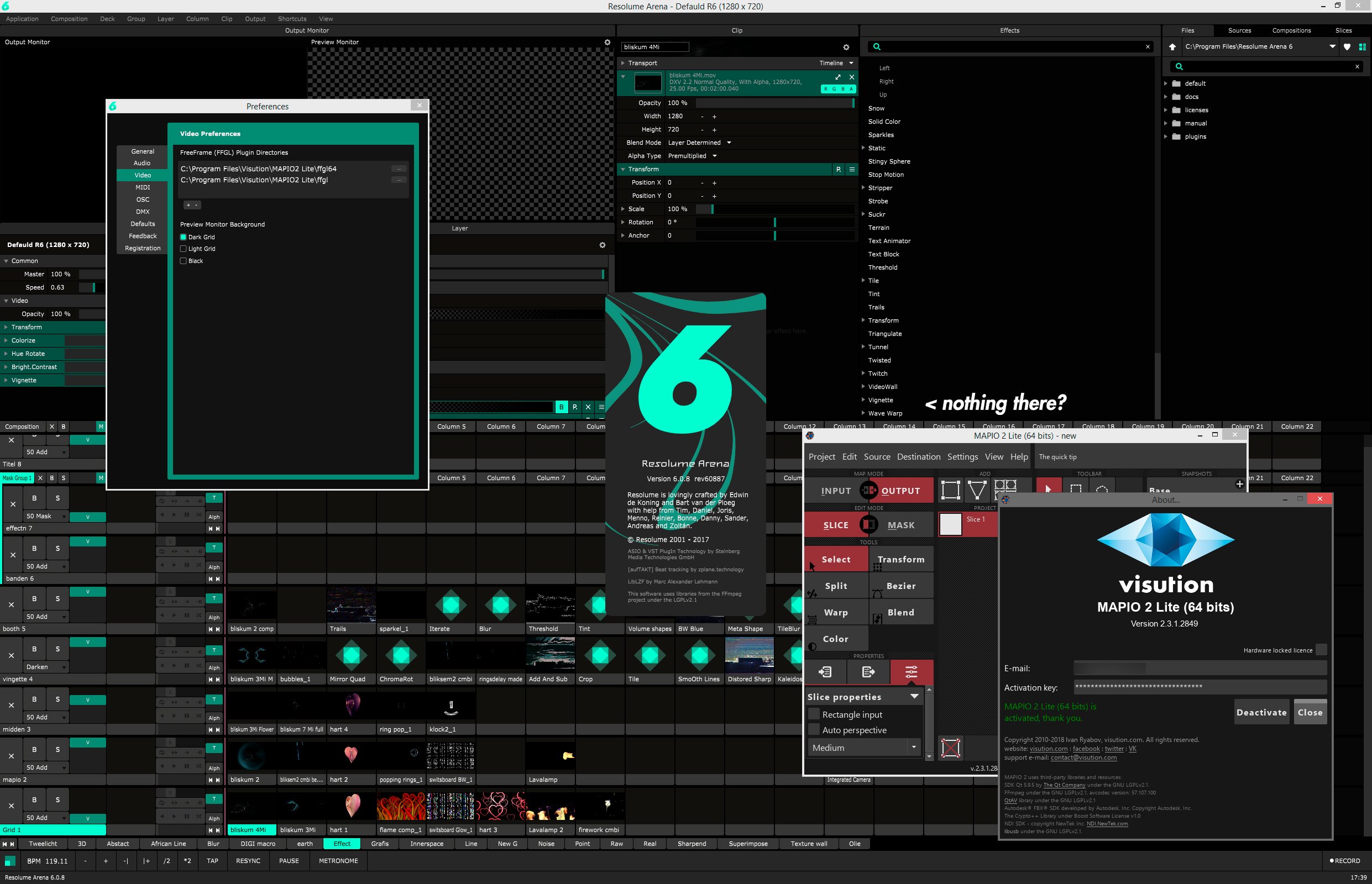

Niice addition, but mapio has disappeared in de effect panel.
i need to roll back until that is fixed
Since Resolume 6, we're overwriting the application folder instead of having a folder for each version. The drawback is that there is no way for the installer to determine if we can safely copy over new presets during installation. Right now we've just introduced envelope presets and it's pretty obvious, but a few versions down the line we can't know if you have an identically named preset, updated the preset with your own values, or threw it out because you didn't like it.
We need to come up with a robust system for this. For now, the quickest way to get them is to throw out your config.xml. This will make Resolume think you have a fresh install and it will copy over all the files. Or you can copy them over manually from Applications/Program Files to Documents.
mapio has disappeared in de effect panel. i need to roll back until that is fixed
We haven't done anything to actively prevent Mapio from working (why would we), so rolling back "until it's fixed" means you might be waiting a long time. It's more likely that Mapio is no longer being loaded because it expects plugins and apps to be in certain places and the update changed that. I'd contact Ivan and check that everything is still as it should be.

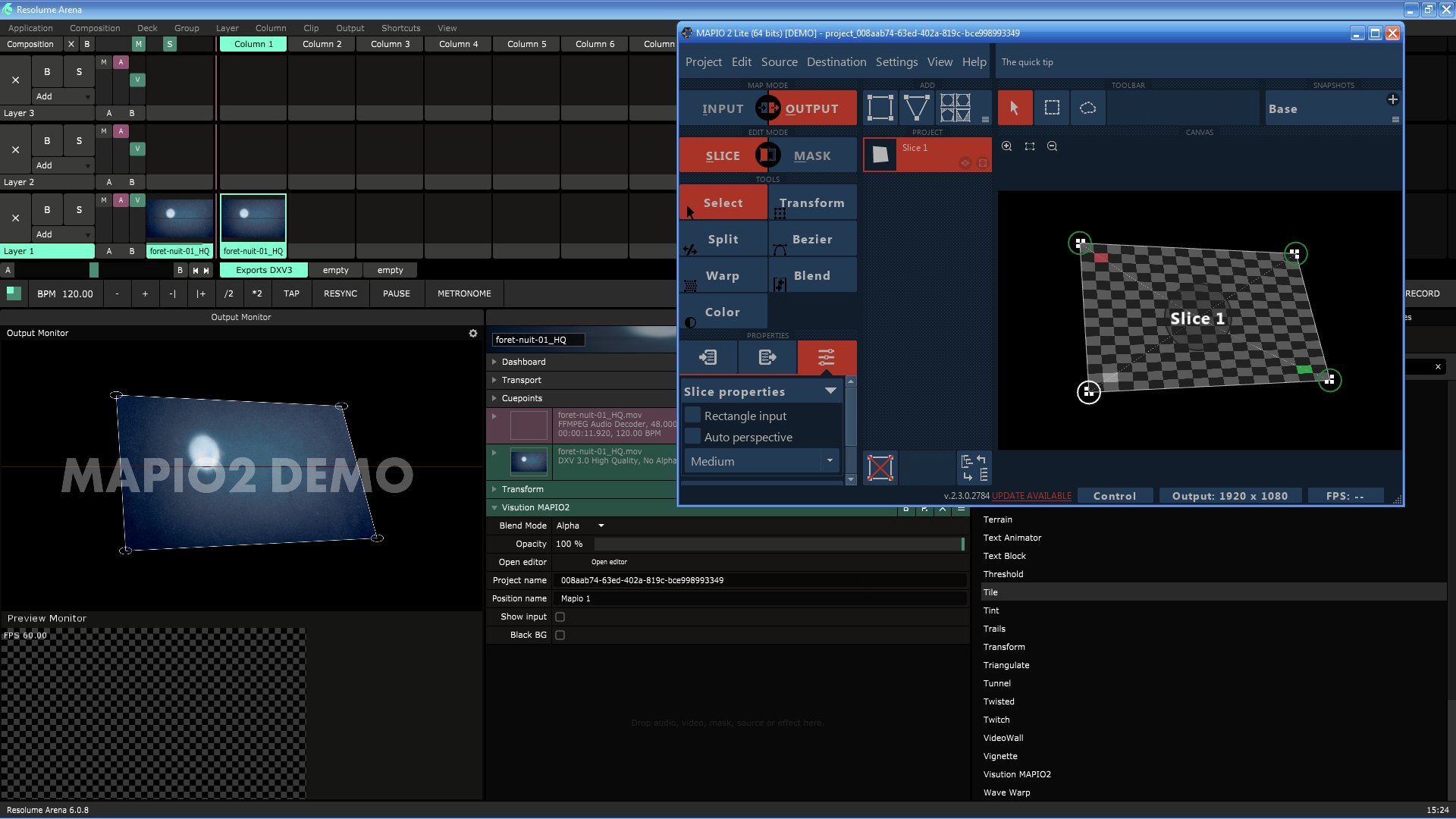

Sjan Top wrote: Tue May 29, 2018 14:01 Niice addition, but mapio has disappeared in de effect panel.
On my computer, Mapio works well in Arena 6.0.8 / Windows 7 pro

i sadly can not say the same thing.
I reinstalled resolume 6.0.7 and later 6.0.8 and reinstalled mapio 2.3.1..
But the plugin is not showing up in de effects browser, but works fine on its own.
The directory is correct and other 3d party plugins are showing and working (not in screenshot)
I know its strange but last weekend everything worked fine before the update.
