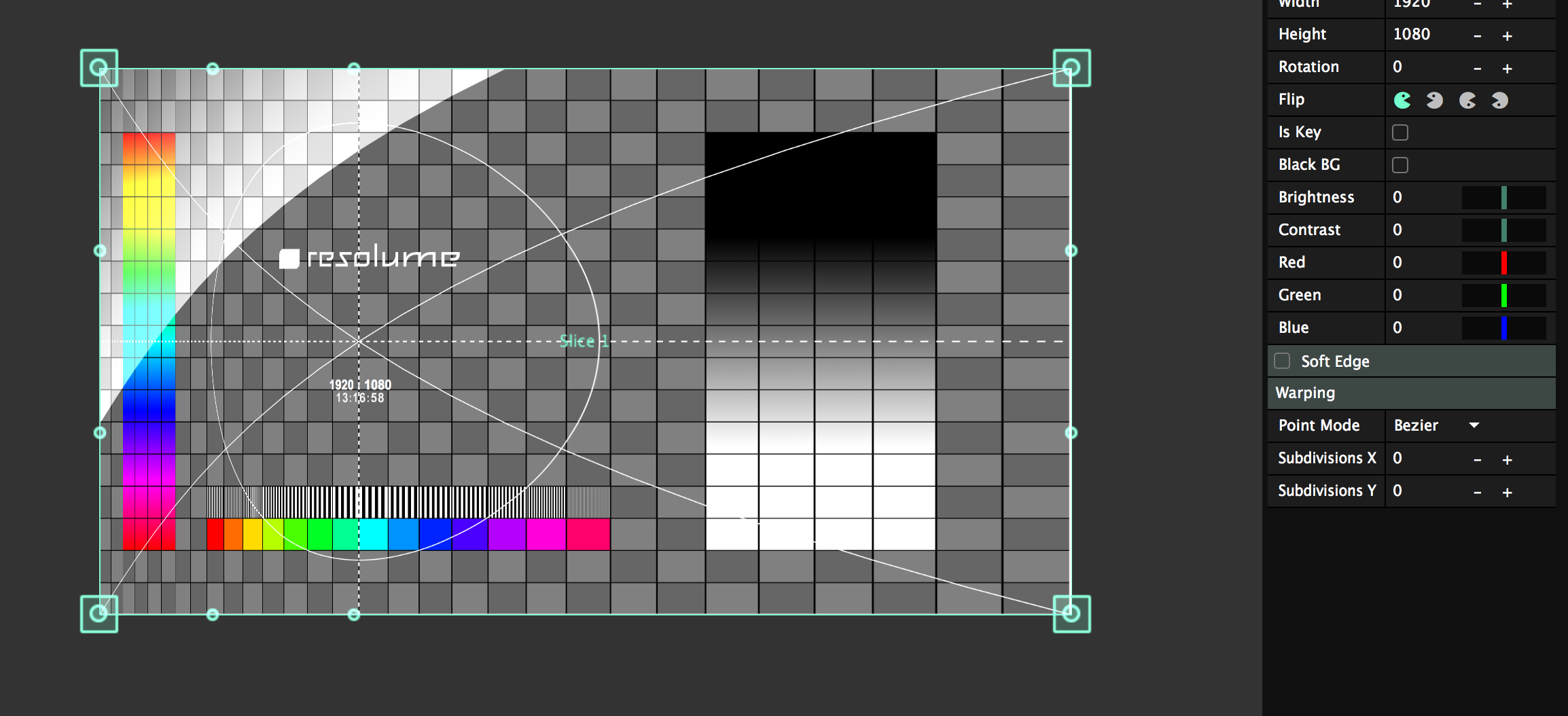

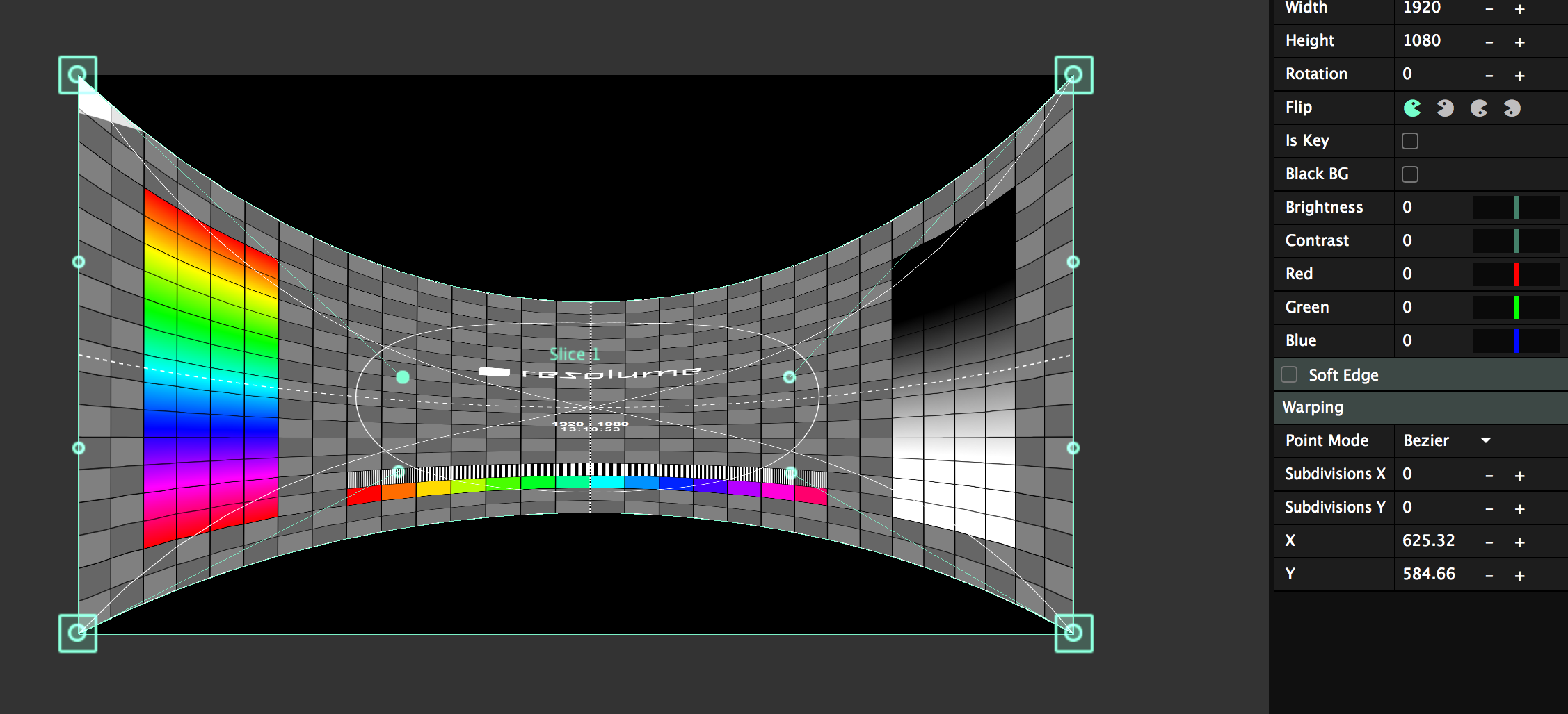

What's the surface you are trying to project on?
Have you tried to set the warp points to bezier mode?
Or adding subdivisions?
If you could share some pictures of your objects we could better understand what you are trying to do.

The beziers did do the trick without subdivisions but it can be a little fiddly.
