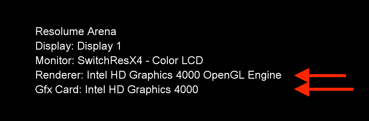

If you switch on Show display info in the output menu, you can check if the connector you use actually comes from the renderer card, so the Renderer and The GFX card should be the same.
If you see the renderer being the nvidia, and the GFX card Intel integrated, then that could be the reason for your bid FPS drop.

If you switch on Show display info in the output menu, and enable the output should see something like this on your actual output (red arrows show what you need to keep an eye on)
Does the GFX card say the same GPU as the renderer?

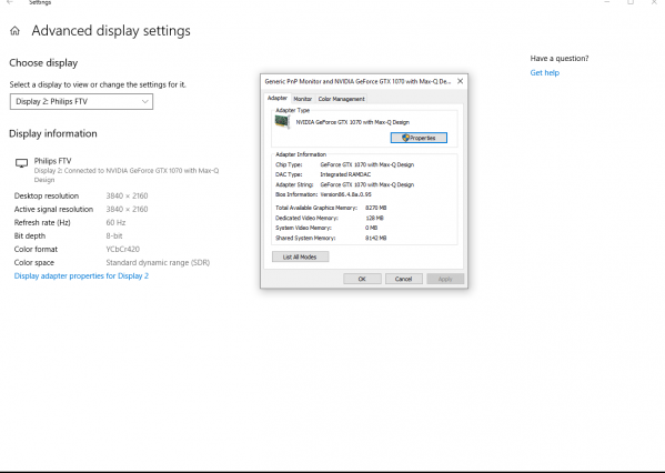

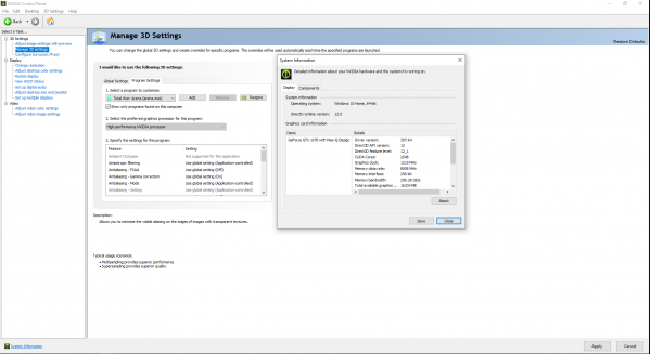

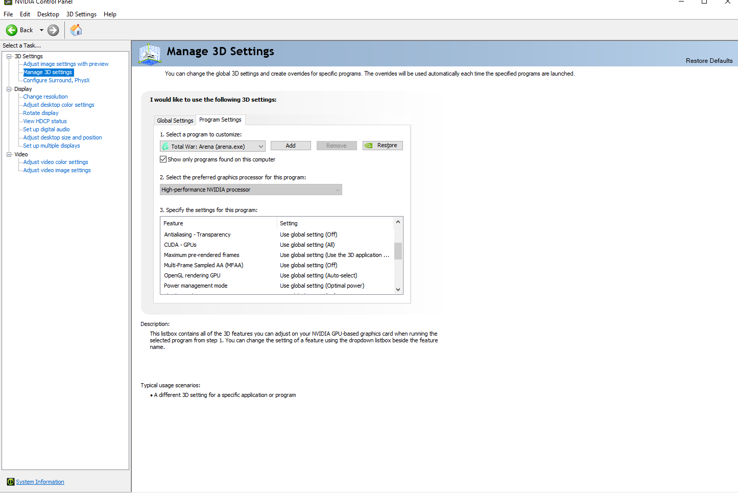

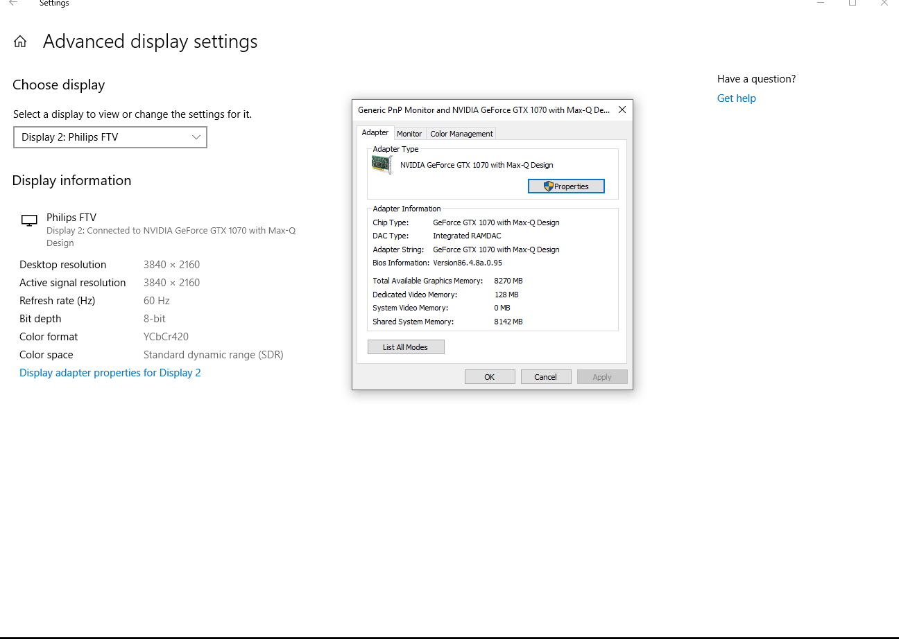

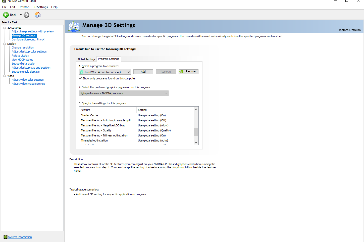

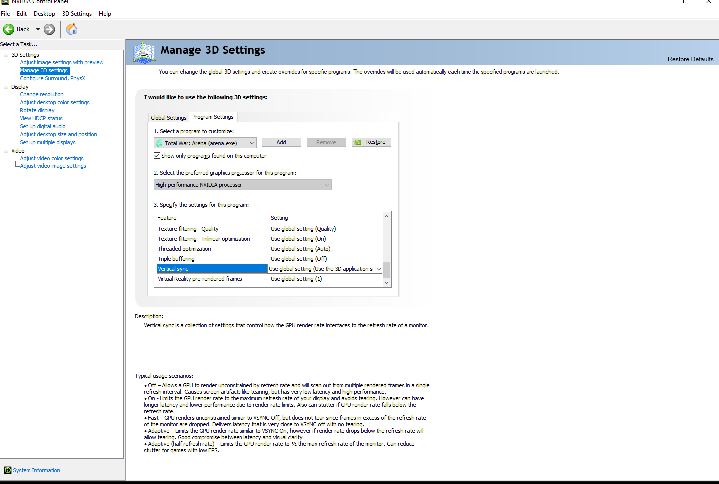

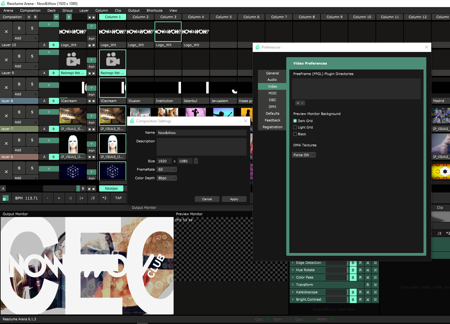

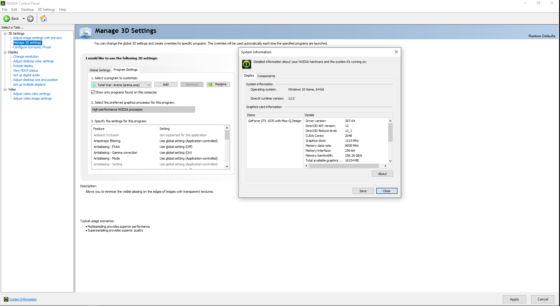

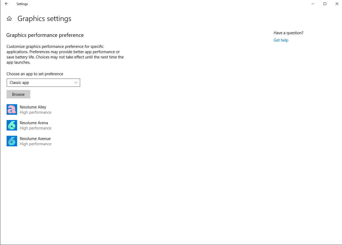

Hi, I have a 15" Razer Blade but with the 1070 in it, and had the same problems, after figgeling a lot with the settings it runs stable at 60fps no matter what, so I've made a bunch of screenshots to show the settings :)
Yuckfou157
Posts: 144
Joined: Wed Mar 28, 2012 16:02
Re: FPS drop in Advanced output
Post by Yuckfou157 »
The driver version is not the newest, but a stable one that's solid an reliable, and you have to check al windows annoying settings regarding scaling and the display, and set everything to maximum performance :mrgreen:
And as always, Master Joris did the math and knows much more...
viewtopic.php?f=7&t=15688&hilit=V+sync
