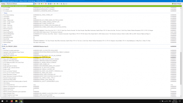

Try download Nvidia Profile Inspector https://github.com/Orbmu2k/nvidiaProfil ... r/releases.
Then edit "Resolume Software" profile.
That solve problem for me.

doesnt resolume check that profile on every startup for changes to correct?elgarf wrote: Fri Jul 08, 2022 15:34 Try download Nvidia Profile Inspector https://github.com/Orbmu2k/nvidiaProfil ... r/releases.
Re: Black flash after hovering/opening files on main monitor
For me arena check this profile only after installing new drivers.
Even after driver updating this fix stay in resolume profile.
OnlineZoltán
- Team Resolume
- Posts: 7773
Resolume only checks if the profile exists, you should be able to edit it.
If you do a clean driver install, that will erase the profile, then you can also try to ignore the profile install on Resolume startup to see if that helps.
I Dont know if that is the solution, i did the enable and indeed no more black-outs.
BUT now im getting random crashes.
Zoltan, i've mailed the crash reports. I will disable it again and see if that fixes the random crashes.

UPDATE,boris.lema wrote: Thu Jul 14, 2022 17:39 I Dont know if that is the solution, i did the enable and indeed no more black-outs.
Re enabling the Nvidia profile resolves the crashes.
Any other work arounds?
I have no problems with this fix at least on my msi gs66.
