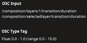

Try sending 0.5
The transition duration expects a float between 0.0 and 1.0, which reflects the range from 0-10 seconds:
Screenshot 2023-07-01 141602.png (15.18 KiB) Viewed 18474 times

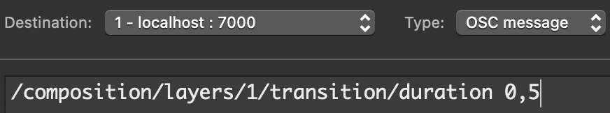

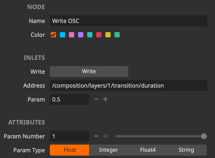

Don't know the correct way to write OSC commands in Chataigne, but the correct command would be
/composition/layers/1/transition/duration 0.5
so the address is /composition/layers/1/transition/duration
and then you need to add one argument with float-type and the value 0.5
As example in Wire this would look like that:
or in Qlab you'd write it like that:
and received in Arena it looks like that:
