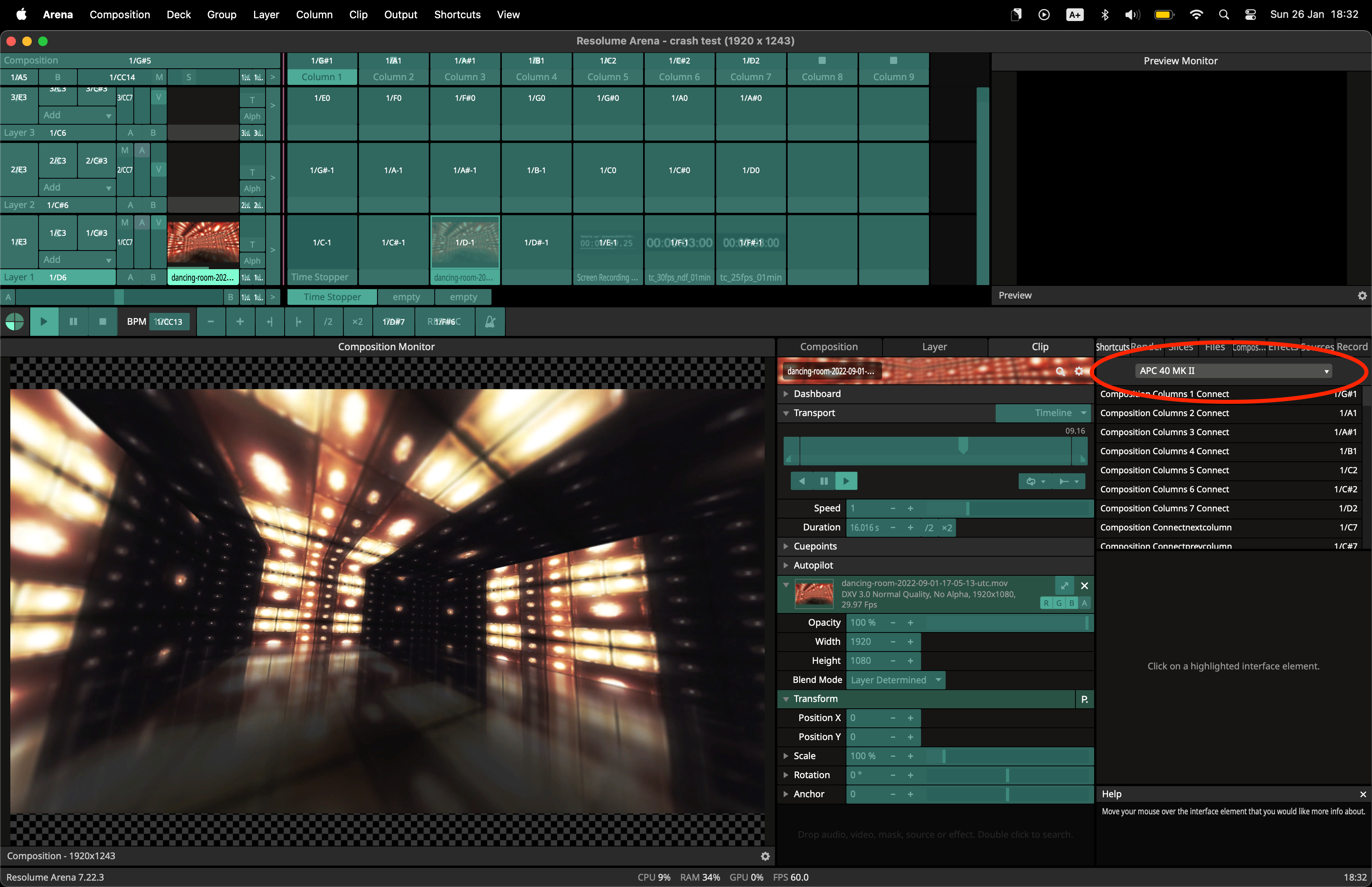

You can easily make different maps for different set ups and save them. A MIDI map is not automatically saved inside the composition. So every time you want a new/different mapping, select it in the MIDI shortcuts panel

Thanks a lot guys, I finally figured it out!!
The thing was I could never see the little toggle with the different presets when in "MIDI shortcut" mode because of the way my screen was split, it was always covered... Duh! :lol:
