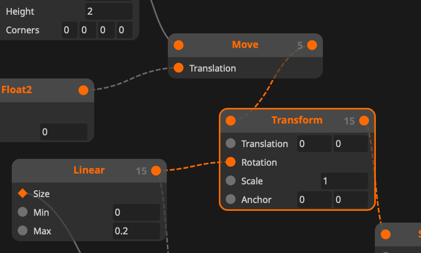

You're already moving the lines on the x axis, so not sure what you'd like to do. If you add Transform after Move, and instance something going into that transform, that can add instances to the rectangles.

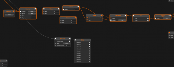

The left part of the patch where you make the triggers go to the next channel could be replaced by a single Circulate node

Thanks Zoltan, circulate is a great suggestion
