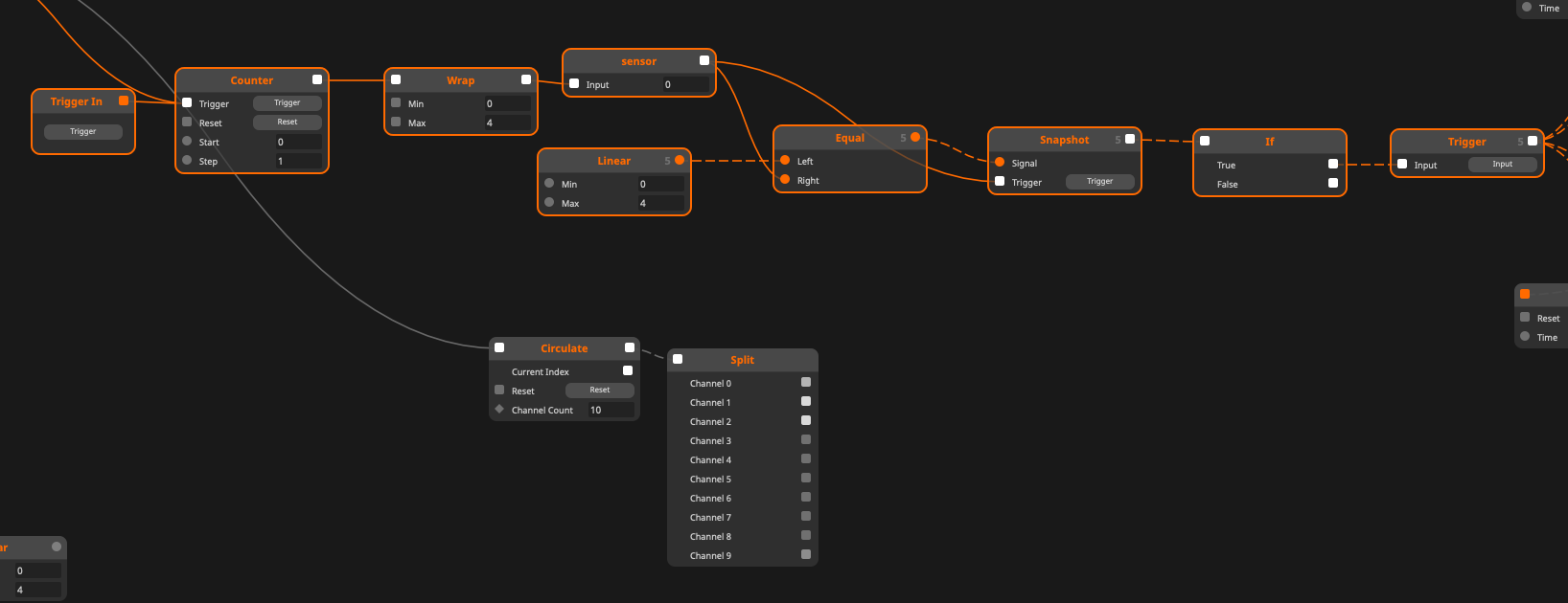

Hi all,
I've create a patch where vertical lines are moving when hitting a button.
Now I would like to instance this 32x times in the x position, and this is where I could use some help.

You're already moving the lines on the x axis, so not sure what you'd like to do. If you add Transform after Move, and instance something going into that transform, that can add instances to the rectangles.
The left part of the patch where you make the triggers go to the next channel could be replaced by a single Circulate node

Thanks Zoltan, circulate is a great suggestion

What I'm trying to do is to have 32 instances of this. So when I play 1 note, the line at position 32 will popup, and make the animation as in patch above.
When 10 notes are triggered, 10 of these animations should play though each other.

Here a version with copies of what I would like to instance 32x times, see included patch.
Any suggestion would be appreciated

I took a look at your patch and I think a different approach would be easier. To have a look at this patch and see if this will help you.
I first make the 35 different lines and repeat them 3 times. Than set up 35 notes to send out zero or one. then I let those notes control the alpha of the lines and the counter for the line movement.

Hi Tijn,
Very interesting to se your approach and a few new objects which I didn't know like the filter note, great stuff.
Also the dynamic amount of notes is a great add-on!
What I'm trying to do is to create a ripple effect when touching a note (also several times), so the movements should continue even if the note is already off.
I'll continue later tonight, thanks again!
