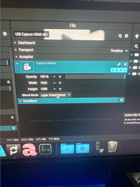

I would classify it as going blank. Just a black screen. Not the "no signal" display either. Just blank.
The USB Capture Source is still present as a clip but it is missing the resolution and is just blank/black. Not sure if that helps classify the issue. See attached image from client. This is what it looks like after re-opening Avenue and encountering the issue.
As for restart that is more rare, sometimes about once a week. Else, they just close the applications and then open them the next day.

Thank you for the continued tips.
However, given this has been tried, and the error still persists, and is having to be dealt with multiple times a week, I don't think that is the core issue.
I have overseen installations that run continuously for weeks and the show file did not ever "decay" or cease to perform correctly.
