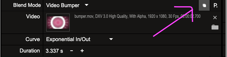

With Wire you can create custom transitions/blends like this. Cloning the Video Bumper could give a nice base.
