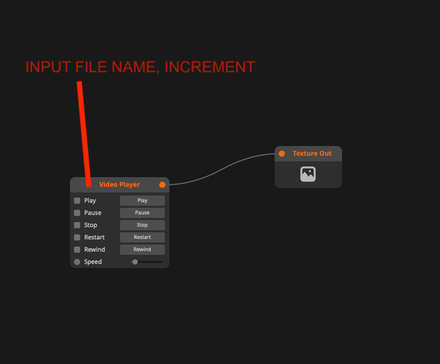

I am still on the search for the best and easiest way to simply play a series of videos in a folder.
Imagine there is a folder called "Weekday" and another called "Weekend".
Now imagine I create a Resolume file for each.
Then, imagine that when Resolume "Weekday" launches it looks at the "Weekday" folder and then plays all of the videos in it in a loop, one after another. Same for "Weekend".
Now here is the sauce. I can then drag and drop new video files into the folder and the next time Resolume "Weekday" launches it re-looks at the folder and puts the new files in there and removes the old ones. Or rather it just only and always plays whatever it finds in there.
I took a look at Wire, which is cool, but I didn't see any patches for files or file names, etc. Just video player. See screenshot. I could totally be missing this...
I have written this in Processing but it is buggy and won't do 4k60. Same with Quartz Composer but it's a dinosaur with memory leaks...
I am looking into how to do this in MadMapper... Nothing yet though...
But.... I would really prefer doing it in Resolume.
Any ideas on how to make this happen?
As always, thanks for the great product!

The Rest-API can be used to load video files: https://resolume.com/support/en/restapi

Re: ow to read video files from Folder using Resolume Avenue or Arena and/or Wire?
That is very interesting. Thank you for sharing.
How might you interpret those documents to make Resolume load files from a certain folder on launch?
I am new to the REST/API with Resolume and the doc referenced looks like it is more about interfacing with all the features over the Web.
Also, I did read through the REST portion but it does still look like a solution mainly for use over the web.
Or, is there a way to make all this happen, with REST, with the web interface, but locally?
Or, or, can there be a patch for Wire where the video player has a filepath? Pretty sure that would solve about everything as the rest of the patches can parse a folder/file structure by the looks of it.
Thank you for the insight!
You can use web calls from command line or scripts using curl, or other apps you make.
The documentation you can reach from the preferences - Webserver tab will give you examples, and the example commands you can run in a terminal.
Could you provide an example or even a section in the documentation that would enable me to load the files from a folder into Resolume on Launch?
I feel the documentation is just a littler too verbose to imagine how this could happen based on what I have read above. I know this may be completely natural to you but I am learning how to do it and I would like to use your product.
Can you please help me understand a little more clearly?
Alternatively, perhaps I should just reach out to a technical sales representative and continue the conversation there?

Re: How to read video files from Folder using Resolume Avenue or Arena and/or Wire?
https://resolume.com/docs/restapi/#/clip/clip_open
If you open the reference form the Resolume preferences, you can also try it out easily with a file of yours.
A terminal script could forward the result of an ls command to curl with an increasing index.
i've made python script that look for new files in folder and auto-upload it to Resolume. If you familiar with python i think i can share it.
https://t.me/vjschool/377
I have the same problem uploading live folders. I have pictures that change everyday and I really would like to just put it in a folder instead of uploading everything everyday...4omp wrote: Sun Mar 12, 2023 11:48 i've made python script that look for new files in folder and auto-upload it to Resolume. If you familiar with python i think i can share it.
Modul8 used to have that...
can you share it with me?
