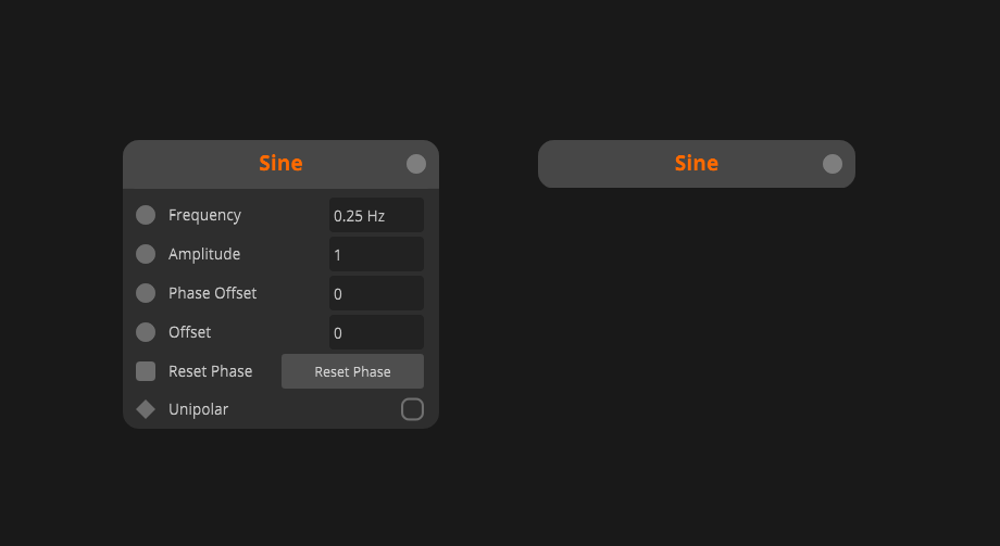

Visibility
Not all features of each node are visible. Some nodes have features that have only a few use cases so we’ve hidden them for convenience. You can adjust the visibility of a node by right clicking it and navigating to Visibility. Here you can turn on and of the inlets and outlets that you desire.
There is also the option to hide all [CTRL, SHIFT, H] or show all [CTRL, SHIFT, ALT, H]. This can be useful to make your patch more readable as well as satisfy your OCD because all the blocks can now be the same size!
