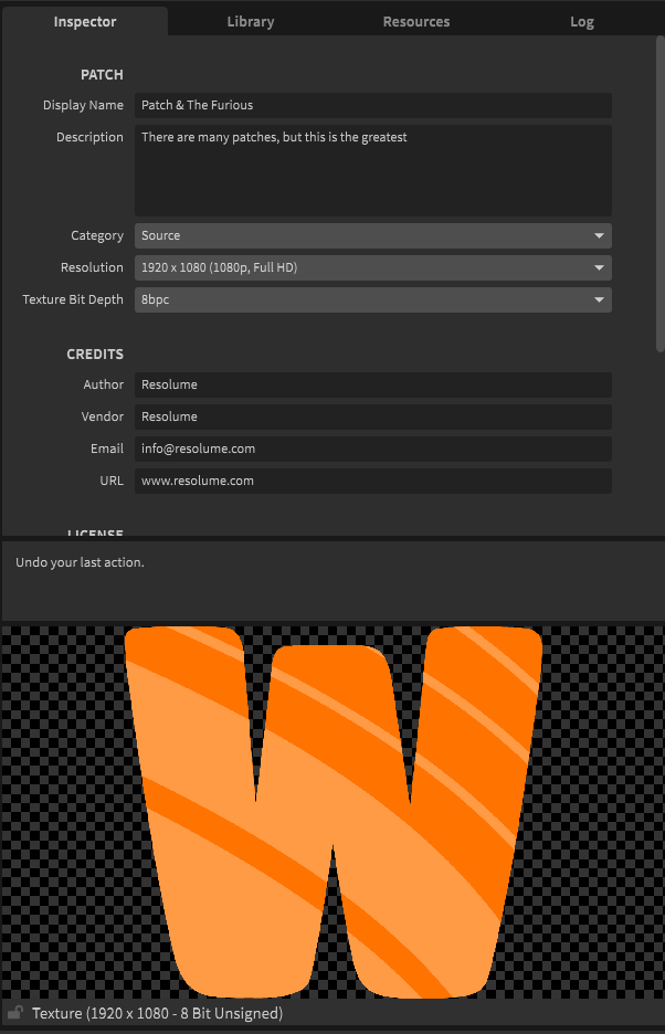

Above the preview screen you will find the inspector, library, resources and log tabs. Collectively this area of the interface is called the inspector. Let’s start by diving into the inspector tab.
Patch Inspector
When there are no nodes selected the inspector will function as a patch inspector. Giving you all the information about your patch in general.
Here you can give your patch a name and a description. This is the name and description that Resolume will use. Category is an important one, here you select how Resolume should interpret your patch. You can choose between source, effect or mixer. If needed, you can adjust the resolution and texture bit depth of the patch.
Below that you can fill in your credentials. This will make sure you get famous.
Lastly there is your license information. This will be covered in more detail in the Saving, Consolidating and Compiling article.

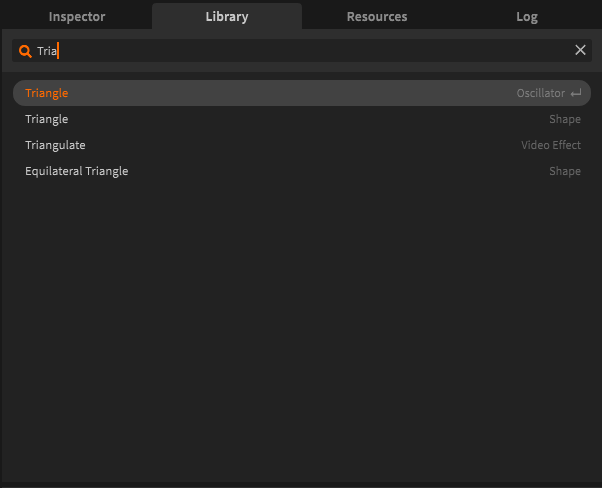

Library
The library is the collection of all the nodes in Wire. Here you can either search for the node you need. Create the node by either double clicking it or dragging it onto the patch.

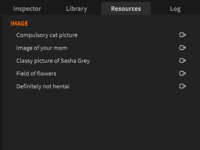

Resources
Resources are external files used in your patch. These can be clips, images or ISF files. The resource tab is here to give you an overview of all resources used in your patch.
Clearing unused resources
If you have any resources that are not used in the patch, you can remove them manually in the Resources tab or go to the Wire tab and click “Clear Unused Resources”. This will get rid of all the files that are not being used.
Consolidation
When saving a patch that has resources, it might be useful to consolidate it instead. This will copy all the used resources to the folder where you patch is saved. For more information on consolidation check the Saving, Consolidating and Compiling article.
