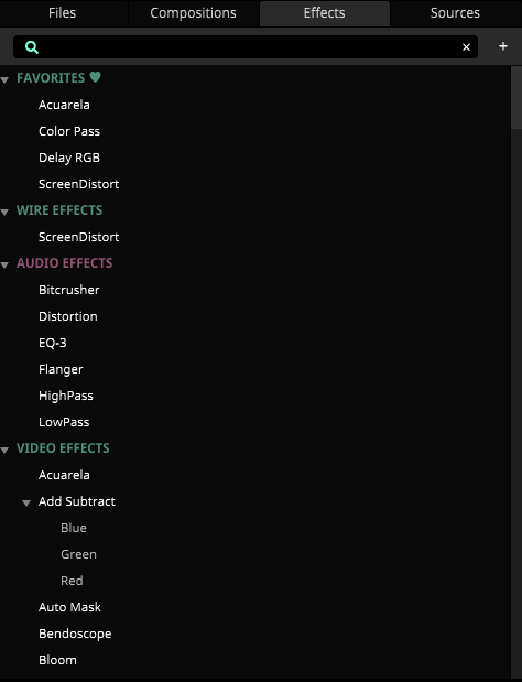

You can find all of the effects in the Effects tab, which in turn can be found in the bottom right of the interface.
To preview an effect, double click its name in the browser. It will show in the Preview Output, applied over whatever is playing in the composition. You can then tweak its parameters, to see if you can get the look you’re after.
If you've found the right effect for the right moment, just drag the effect from the Effects tab onto the area of either the Composition, Layer of Clip tabs. Drop it right where it says 'Drop effect or mask here'. You can also directly drop it onto a clip or layer.
