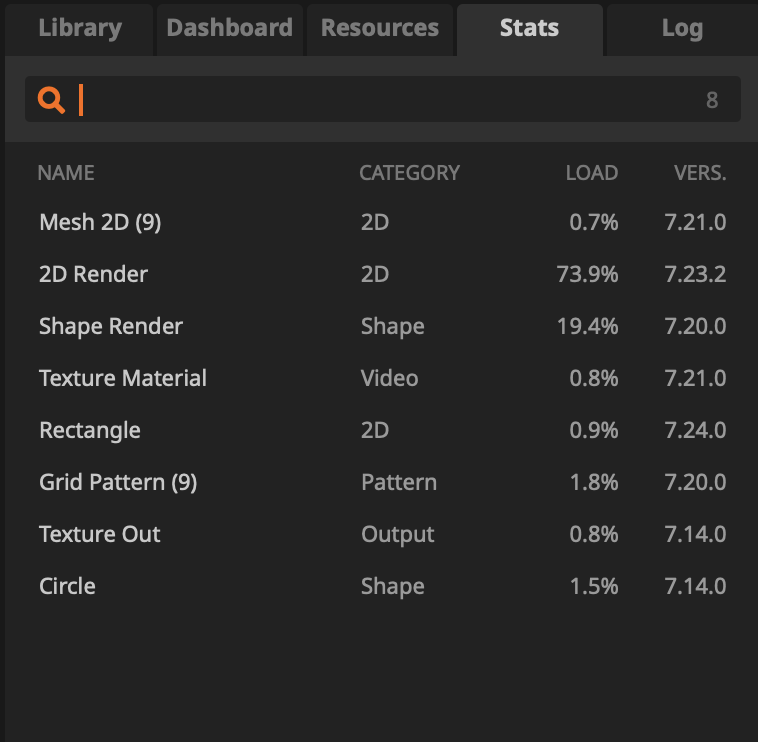

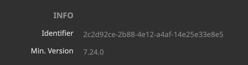

Open the patch and check the Patch panel — it shows the minimum required version for that patch. On the Stats panel you can see per node what version is required for it to run.
The minimum required version for this patch on the Patch panel
The Stats panel shows a list of nodes with their minimum required version
Is the minimum required version always the Wire version used to compile the patch?
No. The minimum required version is based on the nodes/features used in the patch, not strictly the Wire version you compiled it with.
