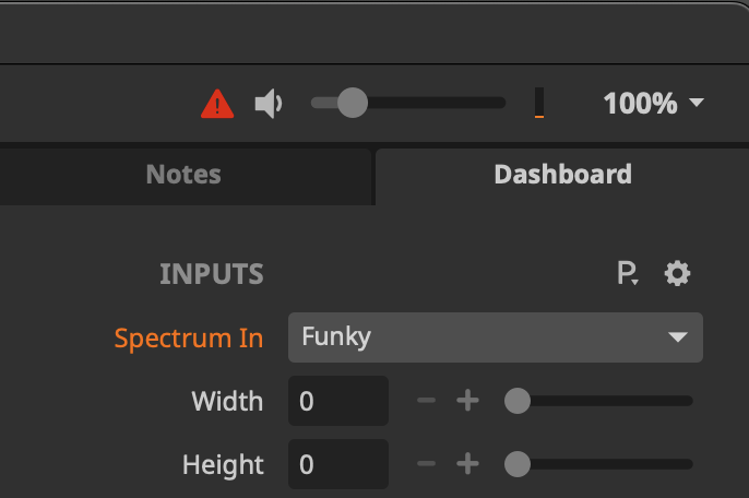

Volume Control
When there is an Spectrum In node present in the patch, the volume slider will pop up next to the zoom indicator. A big red warning triangle will pop up if you don't have an audio output device selected. If this is the case, navigate to Wire > Settings > Audio and select one.
Big red warning icon telling us to select an audio output device in the Preferences

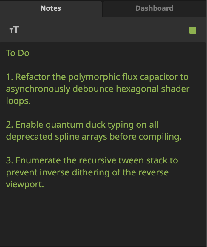

Notes
The notes panel (that is notes, not nodes!) allows you to take some quick notes. Useful for remembering stuff, storing bits of patch (use 'copy for sharing' to copy nodes as text) and making to do lists

Dashboard
The Dashboard tab is the one-tab-stop for controlling all your inputs as well as ordering them as you see fit. This is also the place to be for creating presets.
The order of the inputs is also the order that Arena/Avenue will pick up when you run your patch there. Inputs can be moved by dragging and dropping the name of the parameter.
You can also let Wire sort your parameters for you. Hit the cogwheel icon to find the sorting options.
Additionally, in the same cogwheel-menu, you'll find the option to create input groups. These are containers that can hold multiple input nodes. Groups will show as a foldable sections in Arena & Avenue. Patches with a lot of parameters will greatly benefit from the use of groups as you can now categorize them as you see fit.
Note that to create an organised and user-friendly patch you should always rename your inputs. You can rename nodes by either double clicking the name of the node (either on the dashboard, or the node self) or right clicking the node and selecting rename in the drop-down menu.
Clicking on a node in the dashboard panel that is currently not visible on the canvas will move the camera to that node.
