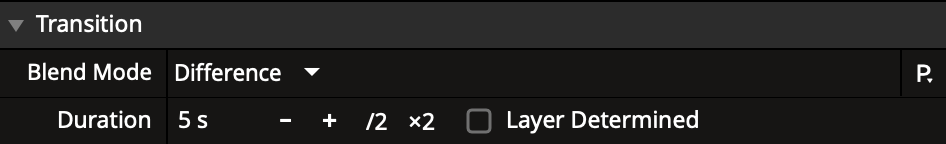

Transition
Generally speaking transitions between clips are managed on a layer level.
However, there are situations where you need control over the transition time and the transition blend mode on a per-clip basis, this is where the transition section of the clip panel comes into play.
By default both the blend mode and duration will be set to 'Layer Determined'.
Disabling this will allow you to set the blend mode and transition duration yourself.
Note: Transition Controls must be enabled for this tab to appear. Transition Control can be enabled through the View Menu.
