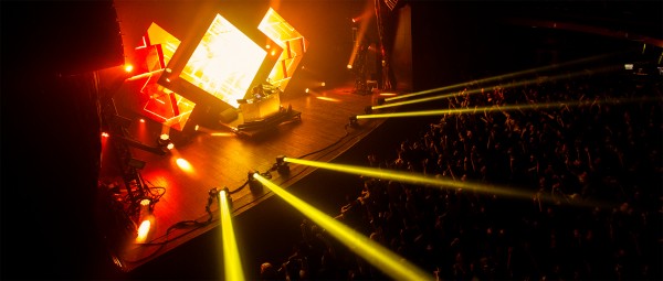

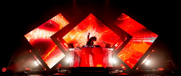

Madeon is a French electronic producer, who uses gadgets and technology like they’re an extension of his very being.
With an on stage setup that baffles even the best in the business, this 22 year old producer has reached where he is because of his focus on the audio-visual aspect of a performance, as a unit.
His stage setup should be trademarked. It’s a diamond with arrow- like shapes on either side.
All made of LED.
Geometric.
Symmetric.

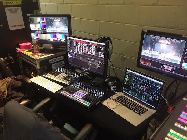

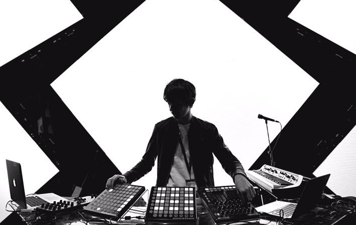

First things first, the answer many have been curious to know, can you explain your live setup to us? All the gadgets you use and their purpose?
The show is run on two laptops which are on stage with me.
One runs the audio side of things in Ableton and sends MIDI through ethernet in real time to a second, dedicated video laptop running Resolume.
I have two Novation Launchpads to play musical parts and modify existing stems, one Novation Launchcontrol XL to handle some additional fx and general controls (including tempo) and a Korg SV-1 keyboard.
There is also a Xone K2 plugged into Resolume to control some video effects.
You do a great job of syncing your visuals to the music. Can you explain to us how you do this with Resolume?
All of the audio clips and parts in Ableton are grouped with matching MIDI clips that trigger videos and effect in Resolume.
All of the editing is done in real time, it's really useful as it means I can edit the video show easily between shows by simply changing the MIDI score.
It also means that I can improvise, extend or shorten a section, with the knowledge that the video show will keep up.

We really like the pixel mapping of the buttons on your Launchpads. Tell us about this.
This is a simple MIDI score sent to the Launchpad to animate it. Novation kindly built custom Launchpads for me with unique firmware features enabling me to switch between this type of "animation" mode and a regular functioning mode seamlessly.

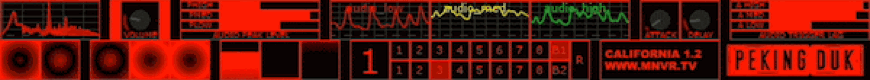

California was initially developed in TouchDesigner to carry the freeform sections of the show but it is now used throughout. Basically I'm using TouchDesigner to do audio analysis live, then I render a trigger based texture palette of sprite animations. They are very simple solid pulses, gradient ramps, animated noise that respond to audio. I send these rendered textures over to Resolume via Spout and position them behind alpha channelled layered animations using Visution Mapio on a layer and column basis. I then launch column compositions instead of running a solely clip based show.
The generative element gives the show added life. Having an automated element sitting behind what I’m doing live broadens the scope of the show and creates a much tighter visual experience overall.

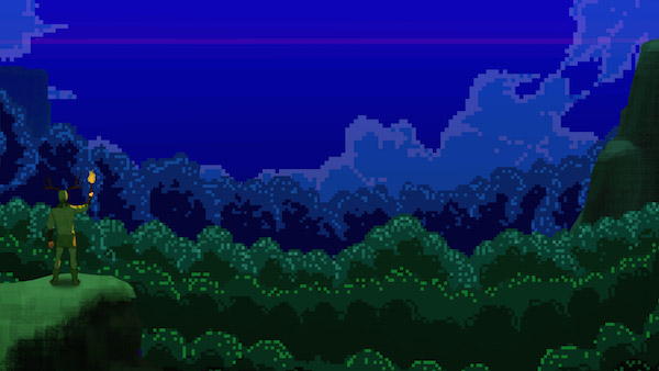

Peking Duk (Adam Hyde & Reuben Styles) are very active on stage and perform with a rotating cast of collaborators, guest vocalists and musicians. The show is never the same twice but is always a hell of a party so the visuals needed to reflect that.
The show is split up into key tracks that Peking Duk are likely to play for which I have accompanying visuals, and then freeform sections that I adapt to on the fly.

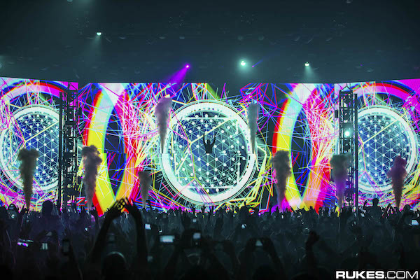

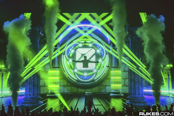

On Tour with Zedd: Gabe Damast
Working for Resolume, we're lucky enough to see some of the most amazing VJ talent in action. One such person is Gabe Damast, whose live show for Zedd blew me away. Gabe is a true VJ and seldom we see a show this tight and in sync with the music. And most amazing of all, it's pure VJ skill, no SMPTE or other tricks.
Take a look at the video for an idea of how Gabe rocks it, and then read on below for what he has to say about all this.

For a normal fly-in show, I use a Macbook Pro Retina with three midi controllers: 2 tractor control F1s and a MIDI fighter 3D. My whole kit fits nicely in a Pelican 1510 carryon case, and if customs ever tries to hassle me I just say "it's for making computer music!!!" and they always leave me alone. Flying around with three laptops sometimes raises a few eyebrows, but I've never gotten seriously held up (yet! *knock on wood*)
How does Resolume fit into all this?
Resolume's simple layout makes it SUPER easy to organize our visual show. I always try to think about telling a story through our video content, and all of my Resolume compositions are arranged in a timeline that I navigate around depending on what songs are being played. Since everything is live, choosing a media server that allowed for quick re-organization was really important to me. Add in the first class customer service from the Resolume team, and it's a no brainer!

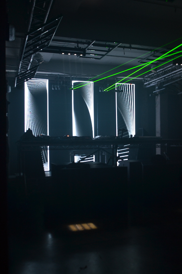

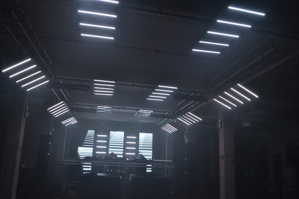

In the video we’re using 70x RGB pixel battens, a 12mm LED screen, 24x green point lasers and 4x RGB sweeper beam moving head lights. Everything runs from inside the new Resolume Arena 5 software. We’re running the LED screen straight on DVI, while all the other fixtures are controlled using a Showjockey 16way Art-Net to DMX box on 16 lumiverses.
We create animation sequences, for e.g simple flashing boxes, and they are used to control the lighting fixtures. DMX works in values of 0 – 255. So, to translate that in to video, black is 0 and full brightness is 255, and that’s how we work with the ranges of each lighting fixture. The moving heads sweep beam lights only have one axis but split in to two sections per light, which is fairly simple to control in theory but was quite difficult to find a working solution without using more layers. For this, we used a gradient source so we have control of the brightness on 2 sides of a solid layer. We mapped the DMX value for the lights tilting to either side of this gradient, which meant we can use Resolume’s automation controls to sync in the movement, or map the movement to a fader on our midi controllers.
The lasers work on a matrix that any value over 250 switches them on, and the pixel battens act like a low resolution video screen so we can extend the content from the LED screen out over the heads of the audience.

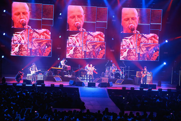

We have been touring for a year using Resolume with no issues. We've been to Argentina (8 cities, 25 shows and we're going back for at least 5 shows more in November), Mexico (16 cities, 35 shows), Uruguay, Paraguay, Panama, Costa rica (2 shows), Chile (7 shows), Puerto Rico (5 shows), USA (13 cities, and we're going back next month to 8 cities), Ecuador (3 cities), Venezuela (5 cities), Guatemala (2 shows, 3 cities), El Salvador, Honduras (2 cities), Nicaragua, Colombia (5 cities) and we are waiting for the confirmation of the Europe tour.
I have been using Resolume since 2.4.1, and have a good 15 years of experience playing with video.
I was called for this tour in May of 2014 as visualist and video engineer. We made rehearsals for a month in Mexico, during which we decided that the perfect system for our tour would be Resolume Arena.
First of all is the stability. I've played HUGE clips from 2gb to 70 or 80 gb, with no issues, so I know i will not have any problem with that. Because we don't run with a backup signal, that's a serious point.
Second of all we have a lot to stuff in our tour. Props (cars, trains, bikes, chairs…), back line, consoles, screens, and everything is travelling with us. As you may notice the screens of the tour are huge, and it is the first thing that we prepare for the show. Build up time is around 4 hours for the screens alone. With other systems it's easy for things to go missing, so the portability is really important for us.

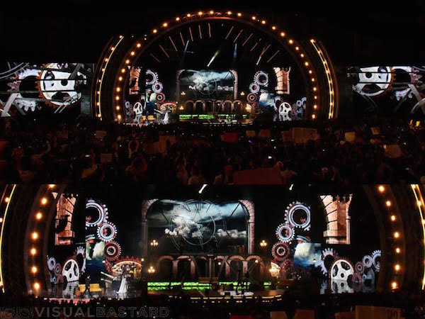

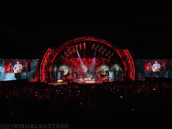

The set up for the show that we use for the tour consists 436 modules of 6mm pitch LED screens. Resolume runs on a MacPro 12core 2,7Ghz /dual gpu with 64GbRam DDR3 with 1TB of storage, and 2 GPU Fire Pro d700 AMD of 6gm of VRAM.
The outputs are set up 1 for the main screen, 1 for the “leeds” or totems by the sides, 1 for the backing for the musicians (moving door), and 1 for the tunnels. The full comp is made for 2115 px X 1080 px, with no scalers, Folsoms or anything, I go straight to the processors with dual links and that's it.
I play the show with an Akai APC40 (older version) and some of the songs had SMPTE sync sent from Pro Tools. A Blackmagic capture card is used to capture an HD-SDI signal that is used in some cues to show the musicians and other live shots.

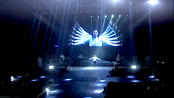

There were no live cameras for that tour. We had PVC screens on which our videos were projected. Each video was done especially for each song (track). During the years, I have been more and more attracted by video art and, generally speaking, everything regarding video production in the music and concert world.
Some of the first interactive video installations I made were with Quartz Composer. I used it to work on musical videoclips and collaborated on other tours in which I have always supervised the visuals and recently also direction and broadcast.
Then, in 2012, while preparing for a tour in the US with Il Volo, my colleague Steve Sarzi proposed to work with Arena. I never heard about it, but after using it with Steve for a couple hours, we had already set the basics for the project I had in mind and most of all, it worked! I was impressed by how fast and easy the software is to use. Also, it immediately read SMPTE signals which was extremely important as I usually work with pre-made videos which are synced.
Tell us about your last work

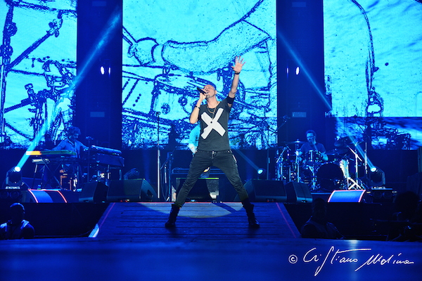

The last job was for Negrita, an Italian rock group that has a 30 year long career. For spring 2015 they had an indoor stadium tour in mind. The lighting and stage designer, Jo Campana, conceived a very essential stage: the background was made of three big LED screens, 5,60 meters tall and 4,20 Meters wide, occupying 16 meters in length.
Because of the importance given in terms of space, a lot of the show was centered on what was happening on these screens. The idea we had was to mainly use live footage and to exclude tracks with simply a video in the background. The live images had been conceived as a graphic element in support of the set/scenic design, so the important thing was that what we were filming had to be processed and filtered to give a different interpretation for each track.
Being a live broadcast, the result was a sequence of live videos that followed the dynamics and the energy of what was going on on stage. No pre-created video could have given the same feeling. The only part we left unprocessed was the very last song, in which all the lights were turned on and the show came back to a more "earthly" environment.
Tell us about the video system you used

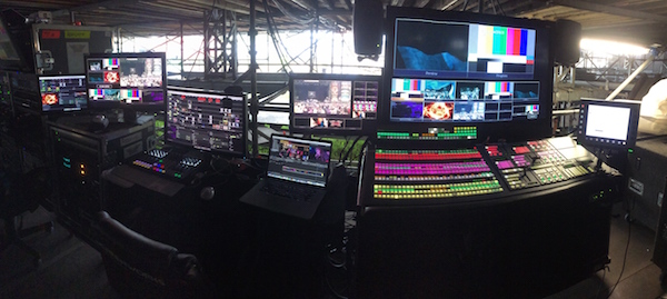

To realize what we had in mind, Telemauri , which is a video rental company Steve and I closely work with, gave us 3 cameras with cameramen, three remotecontrolled cameras plus some small ones which were placed on stage, one of which on the drum set.

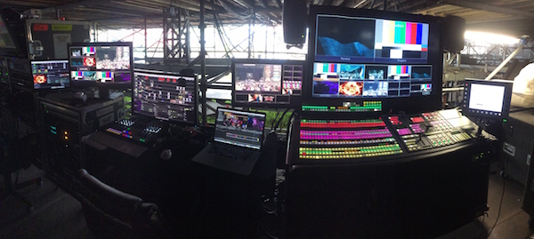

All cameras were routed into a ATEM switcher, which was extremely versatile. Thanks to it we could independently control 4 SDI and 4 other input signals to the computer with Arena.
What came out of Arena, went directly to a video matrix and consequently to the screen. Our output was a single full HD signal, the mapping of the three screens were directly done on Arena, deciding what should go on each screen. I prefer to keep some of the controls of Arena in manual mode, like the master fader for example, so we connected a Samson Graphite MF8 controller to the computer.

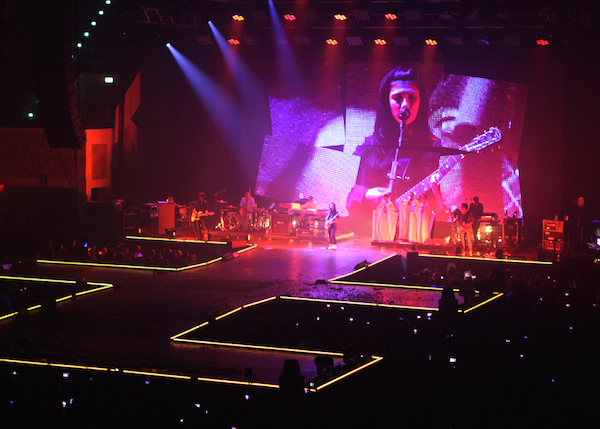

Have you used particular effects?
One of the aspects that made us choose Arena towards other more "prestigious" media servers, is that through FFGL we could develop our own plugins. In fact, also in the previous tour, Elisa's "L'Anima Vola" we created some plugins to make a choreography of the singer moving on stage, while on the screens her movements were repeated several times to create a trail.
Elisa tour 2014
Another plugin I enjoy, which has been developed together with Davide Mania (an FFGL programmer I have been working with for years) we named ScrumblePict. I often use it, and it allows us to have copies of the signals without having to use more of Arena's clip slots . These copies can be moved, rotated, scaled and cropped, allowing to always create different templates.
Elisa tour 2014
Biagio Antonacci tour 2014
Could you show us some of the graphic styles used for the show?
As I mentioned, I very much enjoy working with image decompositions, so in this tour we also got busy with breakdowns and recomposing the signal that came through the switcher.
Negrita live, example of the ScrumblePict effect.
For other tracks, we took advantage of the edge detection and pixel screen effects.
Another fantastic aspect of Arena is the possibility to use DXV files with the alpha channel. In this way we can create moving masks for live inputs.
Negrita live, mask with alpha channel and live inside
More info and other works and productions at http://www.editart.it

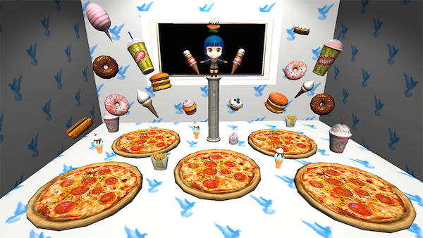

Recently you've been playing with Unity to make realtime visuals. What's the main thing that makes realtime more fun than pre-rendered?
Render time is never fun and playing video games is always fun right? I’ve never been very patient with 3D software. A lot of the 3D stuff I work on has a lo-fi video game aesthetic as well so its sort of a no brainer to start throwing stuff into Unity. I jump in and out of Blender as well but I figured if I’m going to put my time into learning a 3D environment I wanted it to be real time.
Porter Robinson - Worlds still image courtesy of Ryan
Alex my band mate in WIN WIN is way more under hood with Blender and rendered some really weird stuff for our last music video. We really liked the effect of video footage height mapped to a mesh and the objects came out really smooth and organic looking, in part thanks to some render time:
What are the main stumbling blocks you run into when working in realtime as opposed to keyframe everything? What about the liberating moments of the freedom it offers?
Scripting is something I wrestle with. It’s great that objects can do what you want in real time but you still have to tell them what to do! The benefit of course being you can see those changes instantly, and tweak it endlessly.
Controlling things in real time keeps me a little more engaged and expressive. I think coming from a music background makes that important to me.

What were the technical setup and signal flow like?
As VJs we’re often confined to prosumer gear that fits in a carry-on case. Not here. My equipment and the main video system were provided by Screenworks NEP out of LA, giving me access to considerable resources at the beginning of the project. During the system build I was able to pull broadcast-grade hardware and converters off the shelf, test them out, and get exactly what I needed. Having a lab of sorts to experiment with integration was a real luxury. Once the spec was complete, our tech-saavy video engineer went through each piece of gear from camera to screen and shaved off every millisecond of latency possible.
My rig was located backstage with the rest of video world since I needed access to several HD sources and quick communication with the video crew. Resolume ran on a 2013 Mac Pro and captured two discrete video signals using a Blackmagic DeckLink Duo. The card took any combination of cameras and switcher feeds based on my selection with remote panels connected to the main system router. Resolume’s output passed through an Image Pro for genlock and HD-SDI conversion, then went back to the central router so we could place it upstream or downstream of anything else in the signal flow to the LED screen.
For control I used Livid Instruments’ CNTRL:R. It has both regular and “endless" knobs, small drum pads, plenty of RGB buttons, long-throw faders, and a layout that works well with how I operate. Everyone of course has their own cup of tea when it comes to MIDI controllers, but when Resolume is open I almost always have the CNTRL:R plugged in too.
The heart of the video system was a Ross Vision, a high end broadcast switcher with all kinds of mixing, keying, and automation abilities. We had one look driven by the Vision that was a grid of nine different 1080 HD sources with no drop in frame-rate or performance. For another song we had switcher buttons triggering sequences of comic book styled playback based on which band member and camera angle were being shown, then a layer of effected live video from Resolume was keyed into a panel to match the look. Top-notch hardware opens the door to some pretty imaginative workflows.

The trick with this Edge Detection effect was keeping detail on Steven so it didn’t look gaudy, then I added the glare to give it a more elegant feel. This one really popped during “Dream On” when Steven stood on top of the piano with his hair and clothes blowing in the wind from the stage fans. The song opened with a clip of rolling clouds and those fit nicely with this look too.
The most challenging cue each show was called “Face Melt,” where a combination of keying effects made Steven's skin translucent to reveal twisting (Cosmic Strings!) graphics. Most of the time we used this at the beginning of "Sweet Emotion” under moody ultraviolet light, which is incredibly tough to key against. I had presets that got it close and dialed in the rest by hand to make sure content only played over him and didn't spill out over the rest of the image. This look was part of my original Resolume demo for Steven.

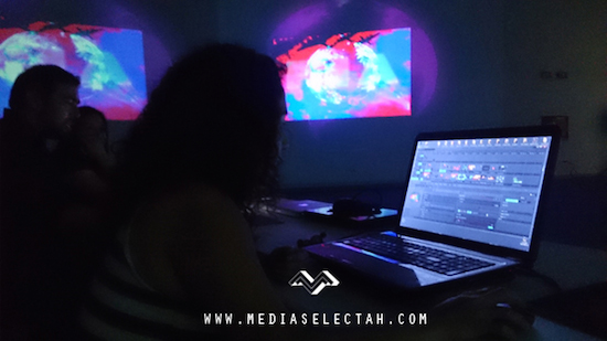

Hello Resolume friends!
I wanted to share my recent experience, taking video and multimedia education to another level.
I was invited to give a multimedia workshop at REYNOSA, one of the cities here in México, where violence has taken over as a result from the drug war. I took the chance, and tried to put fear aside.
It was an intensive 1 week workshop called "LET US PLAY!", all about new media and exploring realtime video possibilities, revisiting artists, techniques, tools, etc. They were introduced to Resolume Avenue software as the main tool to develop their individual projects.
With the support of Media Selectah, we opted to close the workshop with a video projection intervention in situ, where we designed a creative proposal and it was done on the same day. The place, was a big white closed room, used for conventions, we had 4 "little projectors" (2K lumens), but as always we did some magic using them to the maximum, and creating a smaller 3D video space within. Every participant developed their idea in a 3 minute performance, and then they all took part of a jam improvisation where random music was played and they would have to play vj.
They could use the crowd source material where everybody contributed with videos and images in a collective way.
This workflow was inspired by the Exquisite Corpse from the Surrealists. We have done this workshop also
in Monterrey city, Culiacán, Sinaloa; and San Luis Potosí, and it is always a new and different experience.
We love video and multimedia, it is our passion in Media Selectah! So we use it to transform spaces and people, and to open up new possibilities for these hybrid media explorations.
As a VJ artist (Vj Thai), it has been very difficult to do what I like for so many years without giving up, due to the lack of spaces and recognition for the visual as part of everything that has to do with music culture and beyond. So we have worked hard on opening up new spaces for video in art and entertainment in México, by curating and producing multimedia happenings around the north of the country, mainly in Monterrey city.
