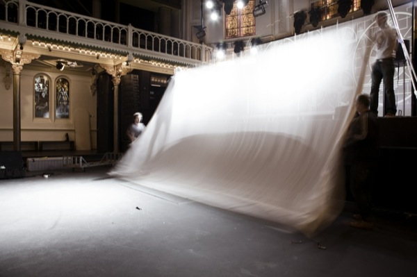

Our name is Beeldjutters, and we have a long-term project which is called Landschapslumen. We create images which we use to transform a landscape into a surreal spectacle. The first version of Landschapslumen was shown at the Dutch Oerol Theatre Festival in 2010. Following a successful try-out year, the installation returned to the 2011 edition of the festival in a large-scale version with 14 beamers projecting onto the sand dunes near the sea. Since then, we projected on the forest, snow, palm trees and other landscapes. Back in those days we used to work with Wings Platinum. Nowadays, we mainly work with Resolume Arena and sometimes old-school DVD players. Resolume gives us more freedom to experiment and to see instant results.
Sneeuwlumen
For our latest project Dwaallumen we need this freedom because we need to create a dialogue in projected images with the dancers, musicians and actors. For example to add extra arms and hands in the shadows of de musician, or double reversed silhouettes of the dancers, or even project a fish with the head of an actor flying through the landscapes. Our work stands in stark contrast to the techno bombast that you usually see in the clubs. Most of the time we don’t use advanced 3D mapping, but focus on the narrative images. However, we do use the mapping options very often to place the images in our landscapes and create the desired composition.
Come and experience Dwaallumen, 3 oktober in Utrecht. Tickets are available at our website. In december, Landschapslumen is shown at Amsterdam Light Festival. For more info, please visit http://www.landschapslumen.nl (mainly in Dutch, sorry!)

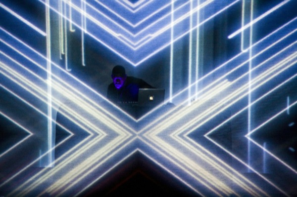

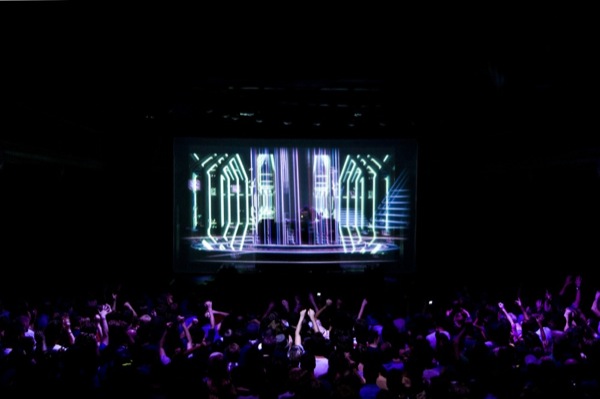

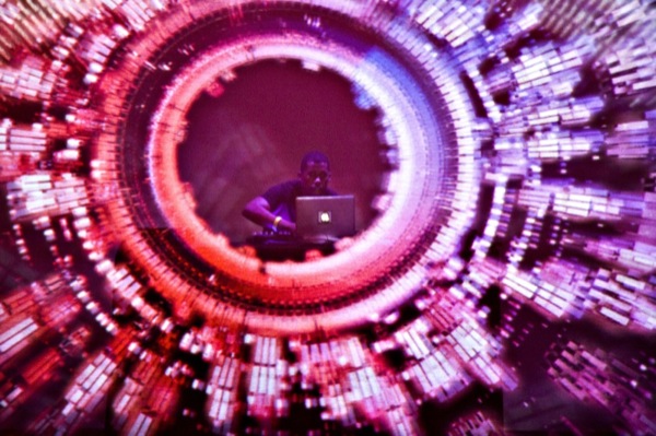

Gorgeous AV Production by Bob White
Occasionally, a certain project will catch your eye. When you start watching and listening, you find yourself drifting away for a few minutes. The acoustic and the optic will blend together to one beautiful harmony.
Such a project is Intermittently Intertwined by Bob White. Take a moment out of your day, and watch this in HD with some good speakers.
[youtubeshort]http://youtu.be/acqIfU-UsaI[/youtubeshort]
We were even more amazed when we found out that the video above is actually created in realtime. It's not often someone is equally talented at music, motion design as well as coding. So we had to find out more about the project.
[fold][/fold]
Bob explains:
Check out more of Bob's work at http://www.bobwhitemedia.com
[fold][/fold]
Bob explains:

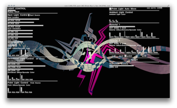

The basic rig is:
Ableton > Network Midi > ofApp > Syphon > Resolume > Avermedia GameHD
In Maya I make a series of quick geometric loft animations and export these as alembic files (.abc). Alembic files are point cache animation files that are typically used to transfer dynamic simulations from say Houdini to Maya. Because I wanted the geometric element to "grow", alembic is a good vehicle as I'm animating vertices.
The brilliant ofxalembic addon loads alembic files as meshes in OpenFrameworks. Because my geometry is fairly low poly count, I can run a lot of them at the same time triggered by Midi notes. Surprisingly even with a lot of polys, playback of abc files is very fast.
My ofApp is very much a work in progress and the code is sketchy at best. The app has ~25 slots for abc files per scene. Additionally, I setup 6 scenes that can be switched with OSC messages. Each abc file can be triggered by an incoming Midi note and there are controls to randomize the playing of single abc files (single actions) or triggering sections of an abc file in sequence (sequence of actions).
I recorded a song I wrote in Ableton and setup a number of Network Midi tracks to send data to my ofApp. I then paint notes that drive the animation. The network midi sends trigger data directly to ofApp. Additionally I send minimal OSC messages to change scenes in my app.
I love the Resolume M4L devices and I would use them, but because I've finalised the song mix in the session view I used the showsync.info M4L devices to convert midi notes to OSC. The OSC changes scenes, clears the screen, and moves the camera. Alternatively, if I were working in the session view, perhaps looping or performing live, I would use the Resolume M4L on clip launch to send OSC.
The ofApp has Syphon enabled so I can display it in Resolume. I have some effects on it like Mirror and Edge Detection to sweeten it up. Like I said, next i would love to explore Ableton control more of the params in Resolume. I would also love to make put this whole app in a FFGL plugin that way I wouldn't have to rely on Syphon. So much to learn :)
Alone the animation is kinda static if it were not for the mirror effect. It's refreshing to be able to easily change the character of the animation using Resolume in real time. Having the ability to "paint" the animation, see the layered effects in real time, I think allows for a more immediate process. For me it's important to be able to work fast so not to get caught up in minutia.

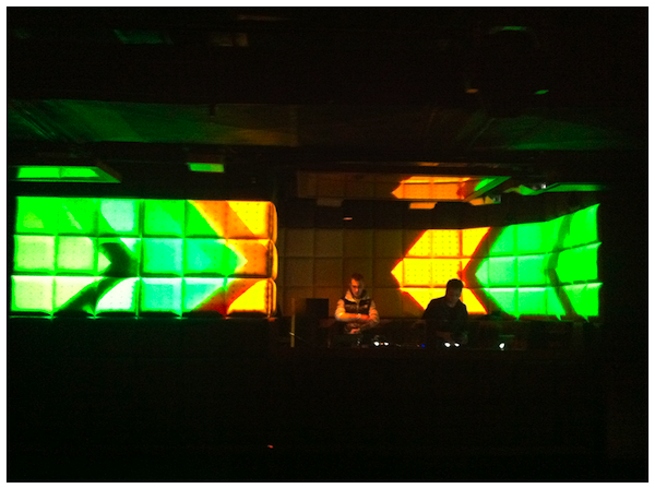

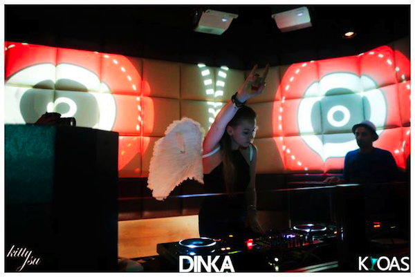

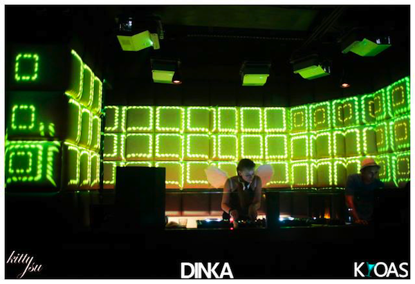

Hands On Club Install in India - Kitty Su
Guest column by Prashant Yashpal from Activ8Media in India....

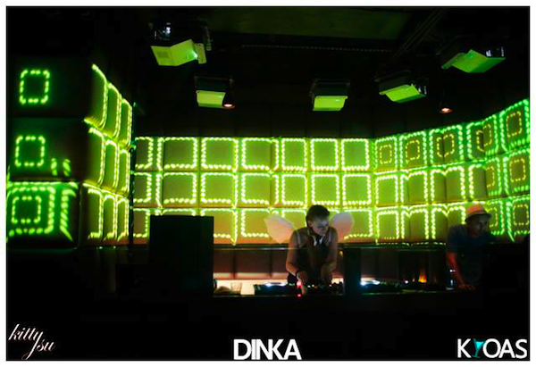

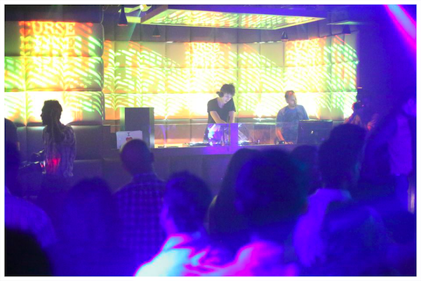

Kitty Su is a popular nightclub in New Delhi, India. For its first anniversary on 18th August, 2012, they wanted to add a visual experience to their club. They called upon their trusted partner Most Technical India, who in turn called us, Activ8Media, to create a video/projection area for the club.
[fold][/fold]
The idea was to create a unique visual experience, around the DJ console. At first we thought about putting regular lens projectors to cover the area, but shadows and projection interference is a big problem in night clubs. People standing close to the DJ console always block projection video and the light disturbs the DJ/VJ/Crew. Installing LED panels would not look good at close range, plus the club wanted to maintain its interior design and look.
So we decided to change the cube fabric from the dark brown which adorns the clubs walls to off-white, to give use better color depth.
We finally decided on taking the risk and using Panasonic mirror projectors, generally used for classroom/business environment. The Panasonic PT-CW230 allowed us to mount the projectors at 10 inches from the wall. The challenge was with ultra-short-throw projectors we needed 7 (!) of them to cover the entire wall.
After lots of research and experiments we decided to go with our favorite VJ software Resolume Arena 4, as expected it did the job beautifully. Using a total of 8 outputs from our beastly PC, 7 DVI’s to projectors and 1 for monitor. Giving an output of 4200px X 550px, we fed each projector with 600px X 550px. We know this is not much but the height and width required from each projector didn't require more resolution.
Arena’s advanced output helped tremendously, we could easily slice our input composition inputs into 7 and feed them to individual outputs, then mapping and edge blending each projector carefully. It was like working in After Effects and didn’t take much time at all, compared to a lot of heavy weight media servers.
Also one great thing after slicing and matching inputs to outputs and saving the advanced output settings, we could easily resize our composition without adversely affecting our real output! All mapping and edge blending remained same as before. This was a life saver! As we were trying to figure out the best output resolution once the projectors we installed and on site.
*OH we only had 2 days for setup i.e. we got the console setup and wiring ready on the 16th and show was on the 18th!
All in all, it was a great experience, the client was thrilled! We had used classroom projectors in a club for the first time, the visual effect was simply stunning, without shadows and strange visuals on the crew :). Something we had not done before, Arena proved to be a champion!
Technical Information
PC - 2.9GHz Xenon Quad Core processor, 2x500GB Hard Drive, 1x128mb SSD Drive (for visuals), 12GB Ram, 2xNVS 420 Quadro (we could have gotten better graphic cards, but the budget did not allow).
8xDVI Outputs - 7 for projector, 1 for monitor.
7xPanasonic PT-CW230 projectors.
DVI to HDMI Cables
BCR 2000 Midi Controller
4200px x 576px Advanced output from Arena, for slicing and edge blending
[fold][/fold]
DVI to HDMI Cables

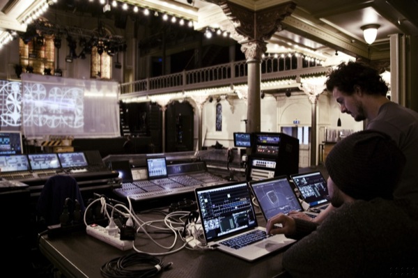

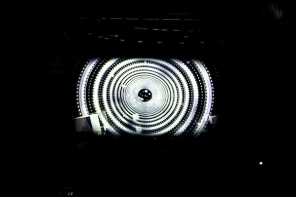

It is wednesday night november 7th 2012, at the Paradiso in Amsterdam, the lights are still on, the crowd is chatting, all waiting for the great Flying Lotus - aka Steven Ellison - who will step onto the stage within minutes and hypnotize us with his wickedly sick tunes and beats.
Not only his music is mind blowing, he now has a visual show to go with it. Those who have been following Flying Lotus and have seen his video clip of 'Until the quiet comes' know that we're in for a treat tonight…
Standing at the front right side of the stage - still in anticipation of the great Lotus - we drink a beer and the 'video nerd' in us starts talking about the 2 screen stage setup...
We always have the tendency to talk through a whole show and discuss how we would do something like this and how it could have been done differently, and then in our over-enthusiasm we totally forget to follow the show and accidentally ignore the people around us who are now beginning to get slightly annoyed by us.
But thank God the lights dim, the visuals light up and Flying Lotus walks onto the stage. A group of hormonal young girls scream in front of us. Something we would never do, of course.
Within minutes we come to the conclusion that this audio/visual setup has been done very nicely. With beamers everywhere, the projection is seamless and with Flying Lotus standing in between the two large screens, he appears and disappears in the overlapping visuals. We're intrigued, so we shut up and enjoy the show.
The group of hormonal young girls on the other hand, do not shut up, so we switch places, towards the left side of the room.
Unbelievable how much space there is to dance in the front, in the back people are humping each other like animals.
Also something we would never do, of course.
We dance, drink, look and listen, and the 'video nerd' in us is not bugging us anymore.
We want to see every side of the show and every side of Mister Lotus, so we make our way to the front of the stage.
The visuals by Strangeloop and Timeboy are nice. The abstract images on the screen in the back and the more detailed animations on the screen in the front work very well together with the music, perhaps a little bit dense at times but it´s definitely a good show all together. The two-screen setup is simple, but effective. We love it when it it's kept simple, you focus more on the total experience of the show.
After he sends his last beats into the crowd, Mister Flying Lotus himself jumps from stage, into the audience.
We hump him and scream like little hormonal girls.
Lovely.
If Flying Lotus was a planet, we want to live there.
XOXO Eliane and Krista - Resolume Party Reporters - signing off ;)

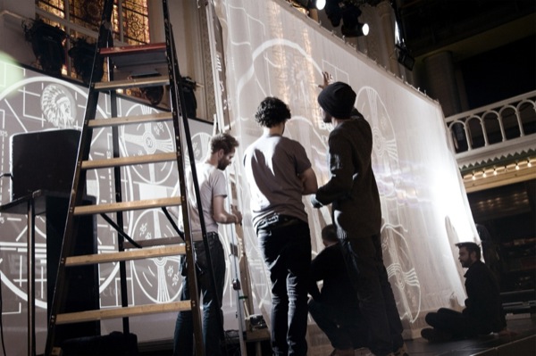

And if you, like us, can't enough of this, here's the making of again:

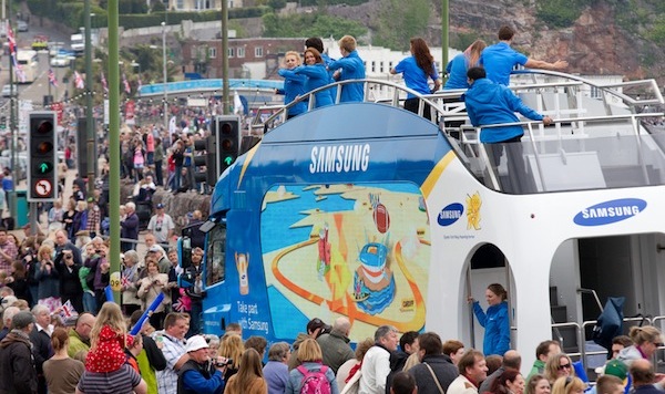

As Described use Resolume on the Olympic Torch Relay
As Described Ltd is a production company from the UK, handling a wide range of projects ranging from small artistic adventures to all out mega festivals to innovative classical music performance.
They had no hesitation in speccing Resolume on the Olympic Torch Relay when they were appointed as VJ’s for Samsung who were one of the offical presenting partners for the 70 day, 8000 mile tour round the UK leading up to the opening ceremony for the Olympics in London.
Jim Horsfield, one of the co-founders and a Director of As Described, has been a resolume user since v1, so when they were approached by the marketing agency representing Samsung to take on the role of VJ’s for the tour it presented them with the perfect opportunity to use Resolume in a different way to the normal club/live gigs that they had used it for in the past.

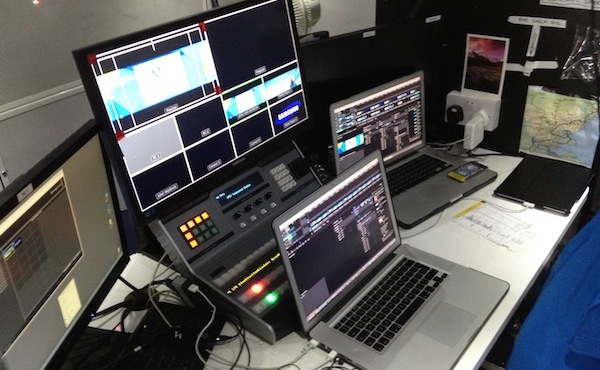

The Torch Relay often started at 6am and went through until 8pm, so content had to be played for up to 14 hrs/day, 70 days in a row.
They used 2 x macbook pros with a Blackmagic ATEM mixer feeding into 2 custom LED screens that were built into a truck on either side.
Adam Seaman, the other co-founder and Director of As Described, even resorted to placing one of the Macbooks inside a fridge as it was so hot. Resolume dropped down to less than 10fps, but it kept going…
Since the Olympic Torch Relay they’ve also used Resolume in more corporate commissions having recently used it to run and control an ‘arts installation’ which they designed and installed for a major brand launch in East London.
Adam Seaman said
http://www.asdescribed.net
As VJ’s for the Samsung Olympic Torch Relay, we were presented with a mixture of content that ranged from pre-rendered video, video that was downloaded and updated daily, through to dynamic flash files which had to be updated depending on the location up to 30 times/day. Resolume was perfect for us as there was no downtime once we started each day, we had to be able to manipulate and change the content order and videos, live without breaking the feed to the screens.
We had a few problems during the first few days, but once these were sorted Resolume ran like clockwork despite the challenging conditions. We had to deal with extreme rain and cold (another typical English summer!) at the start of the tour, but by the end it was reaching nearly 45 degrees Celcius inside the truck.
